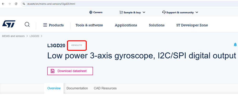

It seems the L3GD20 is obsolete:
But, on the 'Documentation' tab, you can still find the datasheet and some Application Notes:
https://www.st.com/en/mems-and-sensors/l3gd20.html#documentation
