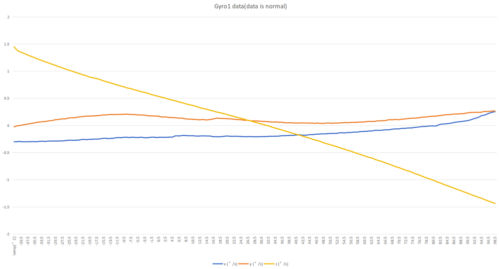

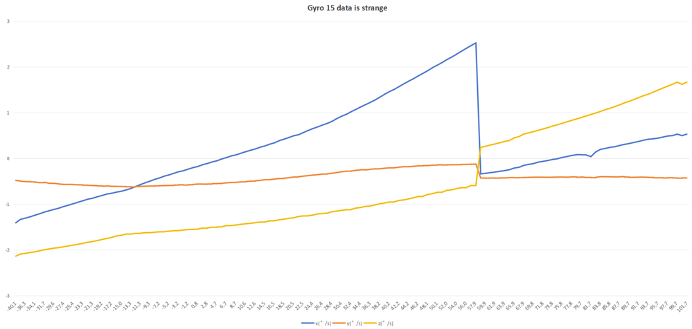

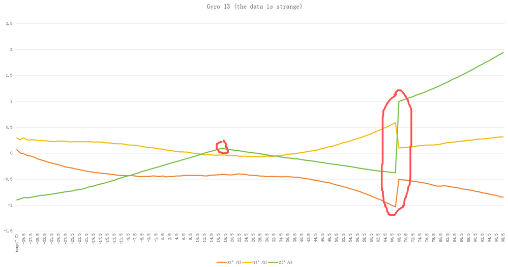

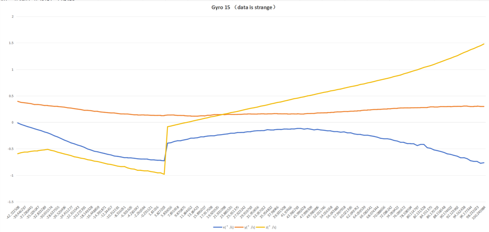

The data in the four figures below are from four gyroscopes on the same PCB board tested in a temperature chamber. The board was placed stationary in the chamber, with the temperature gradually increased from -40℃ to 100℃.
It can be observed that the zero bias data of the first gyroscope is normal with continuous variation. However, the zero bias data of the other three gyroscopes showed abrupt jumps at different temperature points.
This experiment is repeatable: each individual gyroscope exhibited abrupt jumps near the same temperature points in every test, though the exact temperatures were not strictly identical.
