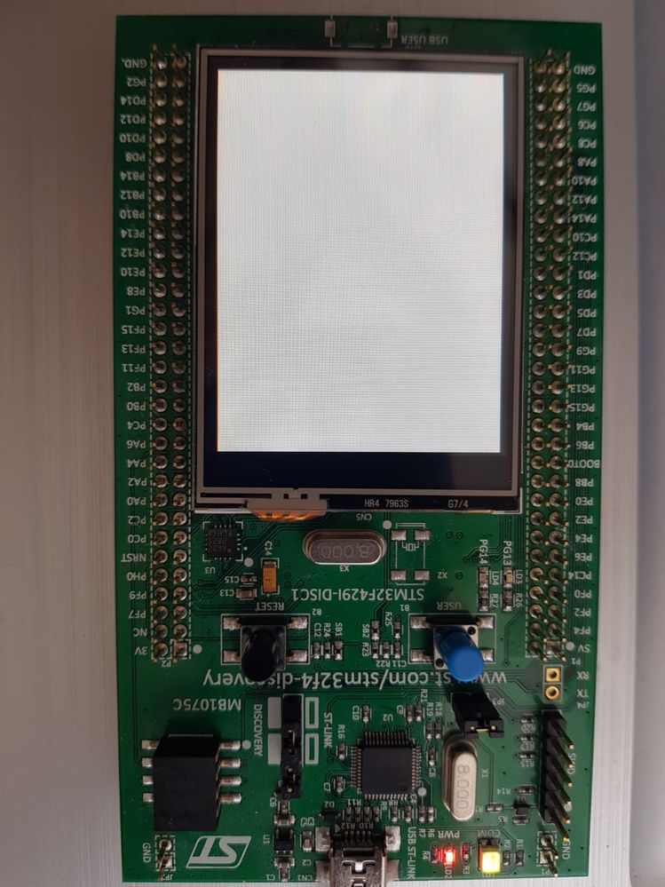

Hi @Eleon BORLINI​ ,
I also do not have access to another mems unit, I'm using the I3G4250D built into the STM32F429ZI (STM32F4-DISC1).
Here is a picture of the board 'm using:0693W000005B2GNQA0.jpgI have also succesfully set and read other registers:

Hi @Fatih​ ,
well, I believe I found the issue...
The fact is that on the STM32F429 the mounted device is the L3GD20 instead of I3G4250D, for which the WHO_AM_I is 0xD4.
You can see it by considering the software package related to this hardware platform, the STSW-STM32138. In the folder Utilities\STM32F429I-Discovery, you can see that in the stm32f429i_discovery_l3gd20.h is declared the following:
#define I_AM_L3GD20		    ((uint8_t)0xD4)
So I suggest you to use this code as starting point, instead of the C libraries on Github.
If it solved the issue, please mark this answer as Best answer so that t can be useful for future users.
-Eleon
Thanks a lot, this clarifies everything. But before I continue development I have one last question;
The manual of the STm32F429i says that the MEMS unit being used is a I34250D : Discovery kit with STM32F429ZI MCU - User manual (chapter 6.8)
Did I refer to the wrong manual? or is it a mistake in the manual.
Thanks in advance.
No it is the correct manual, but checking the 7.2 Board revision history chapter p.30 you can see that from Revision MB1075 - E01 there is a change:
>> U3: L3GD20 replaced by I3G4250D and R75, C54 added
Maybe the board you have is from another version, the B01 or the C01 (it looks "C" version from your picture, from MB1075C marking)
-Eleon
