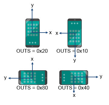

Hi ST, I'm working with LSM6DSO on gesture recognition. It would be great if you could share fsm examples especially for 4D app. Thank you! John
2019-03-28 4:39 AM
Hi John, yes of course, you can check a dedicated post here:
I attach you the example to be uploaded in Unico, referring to the configuration below
Please note that the same FSM code can be used also for LSM6DSOX
