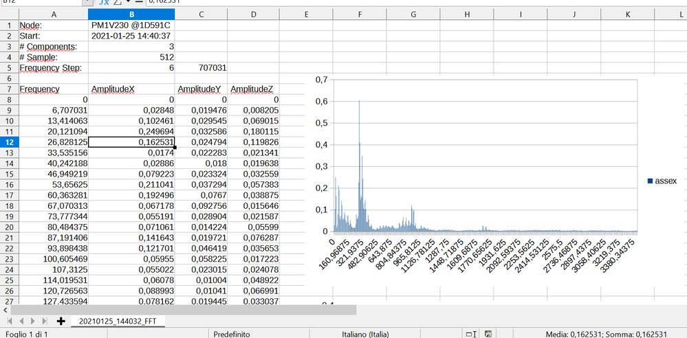

2021-02-23 3:40 AM
Hi @Eleon BORLINI
thanks for the answer but it doesn't explain what I was asking, I'll show you what value of the FFT I need to evaluate so you can help me further.
The image attached is the representation of the FFT points acquired by the log of the PREDMNT firmware. I would ask you how are the amplitude values that you can seein the image related to the acceleration sampled by the accelerometer.
Thanks for your time and patience.
Andrea
2021-02-23 6:58 AM
Hi Andrea @ABent.1 ,
Thanks for sharing the data for better comprehension.
As written before, the value in AmplitudeX, AmplitudeY and AmplitudeZ columns are expressed in m/s^2, meter on second square, the standard unit for the acceleration. They refer to the FFT values for each of the frequency points (in Hz). To convert these into "g", you have to divide them by 9.81m/s^2, and to get back the LSB you have to multiply them for 1/1000 * 1/sensitivity in mg/LSB.
Is it clearer now?
-Eleon
2021-02-23 7:08 AM
Hi @Eleon BORLINI ,
thanks for the fast and kind reply, now it is clear and you have solved all of my doubts!
Best,
Andrea
