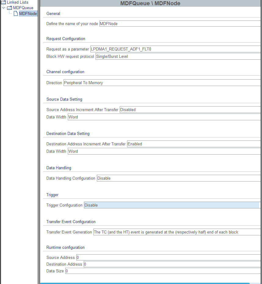

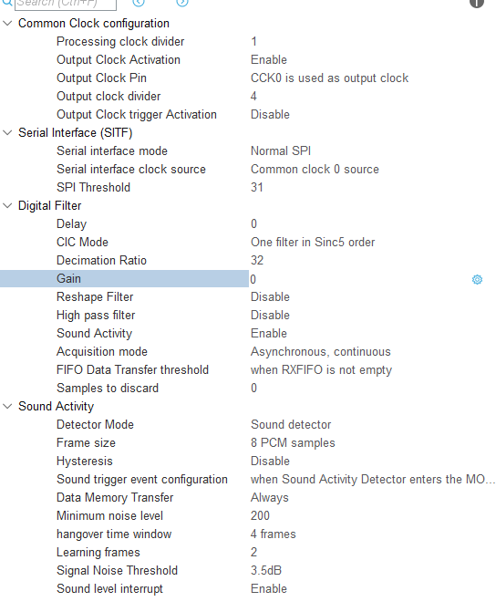

Hi, I have the same MEMS sensor and an Nucleo-U575
I am trying to turn on a light when the sensor hears something using the SAD.
My configuration is as follows:
I have as ADF input clock: MSIK@12MHz
Then a Output clock divider set to 4. So my output clock would be 3MHz.
pins are:
PE9: ADF_CCK0
PE10: ADF_SDI0
This is the LPDMA section(copied from the ADF_AudioSoundDetection example):And this is my callback function
void HAL_MDF_SadCallback(MDF_HandleTypeDef *hmdf)
HAL_GPIO_TogglePin(LED_GREEN_GPIO_Port, LED_GREEN_Pin);
Unfortunately nothing happens.
