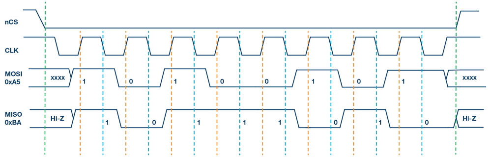

The third scenario, i.e. nCS pad transition from Vdd to GND, followed by the clock activation, is the requested one. This is valid in general for the SPI communication, and explicitly for ST sensors, since it is the trigger for the ASIC internal SPI state machine, as suggested by yourself.
Please note that usually ST sensors run in SPI Mode 3, as depicted here below:
-Eleon

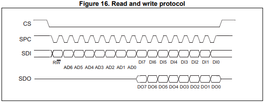

Hi @Community member ,
the SPI communication starts after transition high to low of the CS pin, as you can see in the datasheet, p 29.
Are you keeping the CS pin low all time before starting the SPI communication? If no, you correctly have to "toggle" the pin (asserted-deasserted) as already suggested by you.
