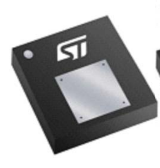

2019-12-13 6:18 AM
The top of the LPS25HB package has 4 little holes, that allow the outer pressure to be equalized with the inner pressure and if the soldering process is not "clean" (any kind of contamination) one of the risks is that these holes can close. About the soldering profile, I suggest you refer to this soldering guidelines, p.10: they are for MEMS microphone but being the this sensor one of the most "gentle" sensors for the soldering p.o.v. they can apply also on other sensors. Ps: no we use the lead alloy no more =)
