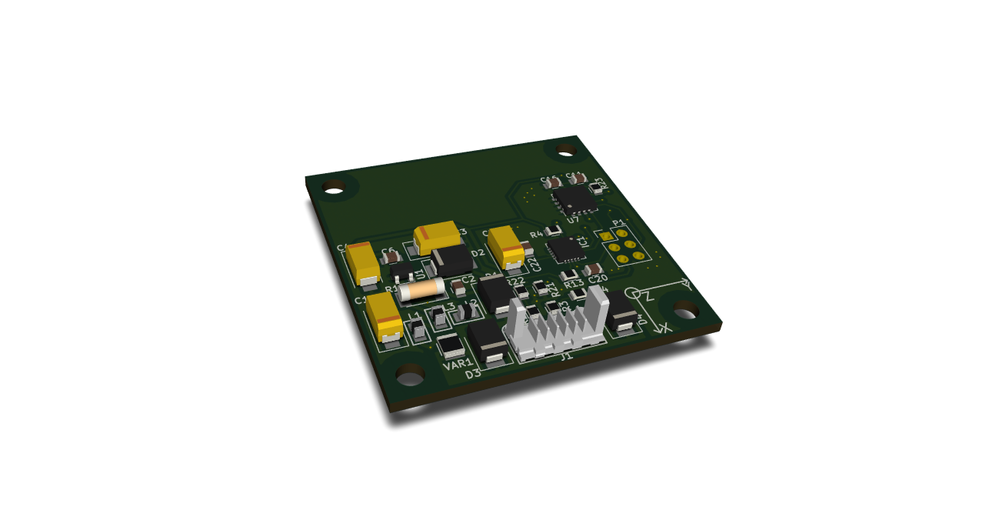

Dear all,
I'm writing .cpp driver for Arduino for the LIS3DHH but something seems wrong.
No replies from the accelerometer.
Do you have any suggestion on the SPI correct communication task reading my files?
