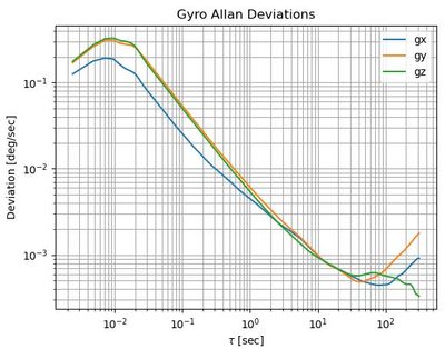

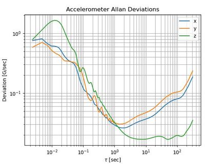

Here is the Allan Deviation of the right IMU on the board :
I don't get any interruptions on the left IMU (like before)

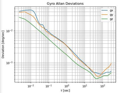

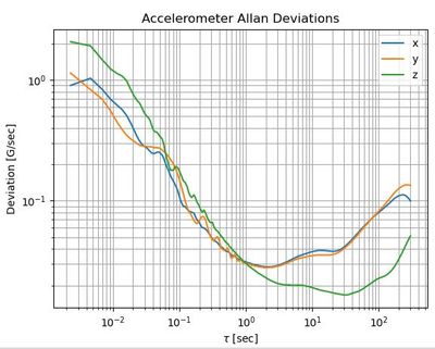

Also for the Board 1, on the right IMU :
For the left IMU, I only have few interruptions and nothing after, I hadn't this behavior before.
It seems that we have a lot of issue on the left IMU and nothing on the right one.
