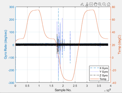

We are using 4 ASM330LHB in our application. We have placed 4IMU's on PCB. We put the PCB in temperature chamber to observe the sensor behaviour during the temperature variation(cooling) with 1deg/min from 30 to 60 to -20.During this test all sensors in static only. During cooling, the sensor bias or readings changed significantly as shown in attached file. Why sensors readings changed significantly?.
Each plot has 4gyroscope readings. In attached file The last 3Plots are zoomed version of first 3plots respectively.

Thank you for reply.
Please find the attached screenshots. We designed schematics as per TN0018 document @ section6.10.
We have 4 sensors, each one communicated independently to MCU with 4SPI's.
The data taken with following configurations.
1.ODR 416Hz.
2.Range 500 deg/s, High performance mode.
3.voltage3.3V

We have been seeing this issue now for some time on the ASM330LHH, and have not yet managed to get to the root cause, so it's somewhat reassuring to see that you can also replicate the behaviour.
We have tried multiple board configurations, including connecting directly to device's pads to rule out any CTE mismatch between the component and board via the solder joints.
We have also tried the same test whereby we switched off the thermal chamber to make sure that wasn't having an effect. The spikes remained.
Please see one of our plots below, which looks almost identical in behaviour to yours. Have you got any further with solving it?
@Federica Bossi- Given two independent users have replicated the same behaviour, can you offer any further support?
