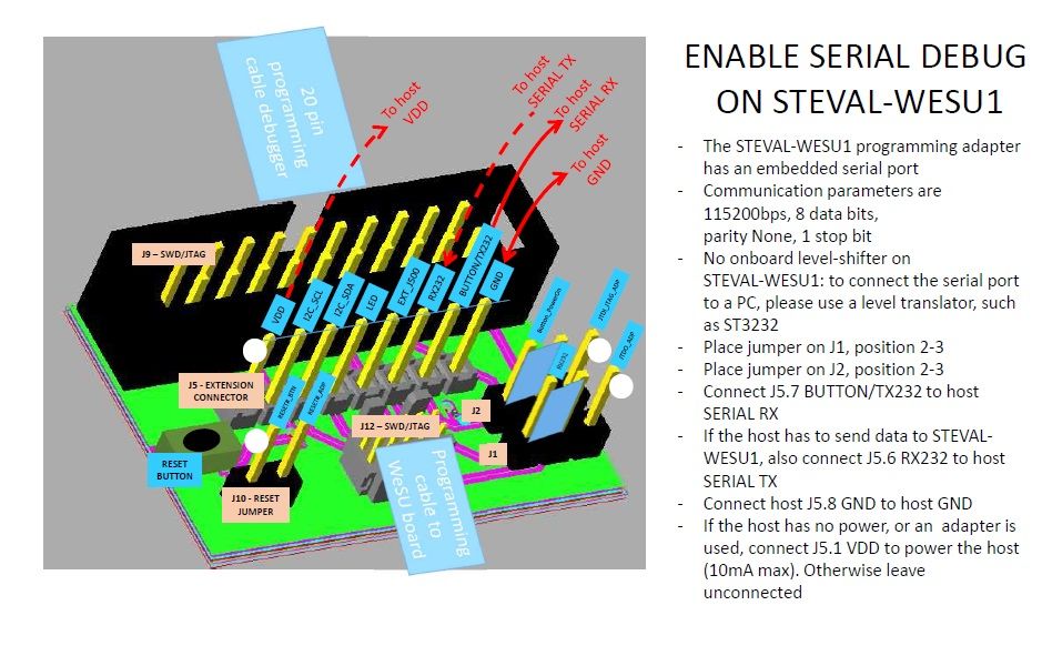

1.move J1 to pin 2-3, and move J2 to pin 2-3 on the small adapter board.
2. now on central strip you have RX and TX lines, and specifically on pin 6 and 7 of it. please refer to below image
3. to capture the serial information you need a RS232 to USB adapter (there are many in commerce) or you can re-use a Nucleo Board, in this case you have to connect above RX and TX on CN3 (on ST-Link side).
Please note: these are RX and TX for STM32 on ST-Link, since you have to connect TX to RX and RX to TX.4. To avoid the STM32 on the nucleo conflict with STM32 on WeSU you have to isolate it: remove JP5 and JP6, connect JP1.Hoping this help

Can you please help me to get the debug UART logs from this board (STEVAL-WESU1) ?
I can see lot of PRINTF() in the given demo example, can you please help me on this ?
It would be helpful to debug the examples.

2018-06-01 10:03 AM
Hello Titus
the UART connection are indicated on pag.19 of UM2041.
