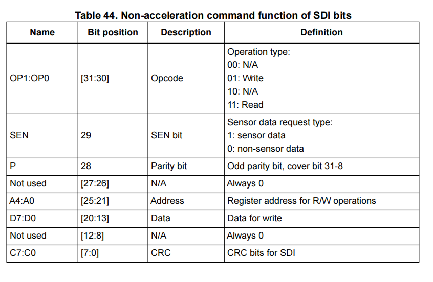

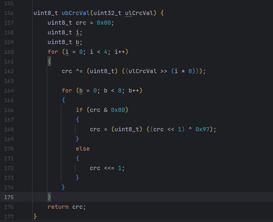

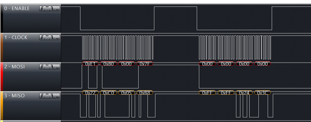

Could anyone give me some advice on debugging the AIS2120 accelerometer sensor? I've included my CRC check function above, as well as the data sent and received via SPI, but I still can't read the correct sensor ID. Thank you very much for your help!

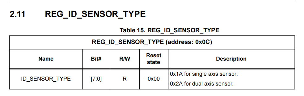

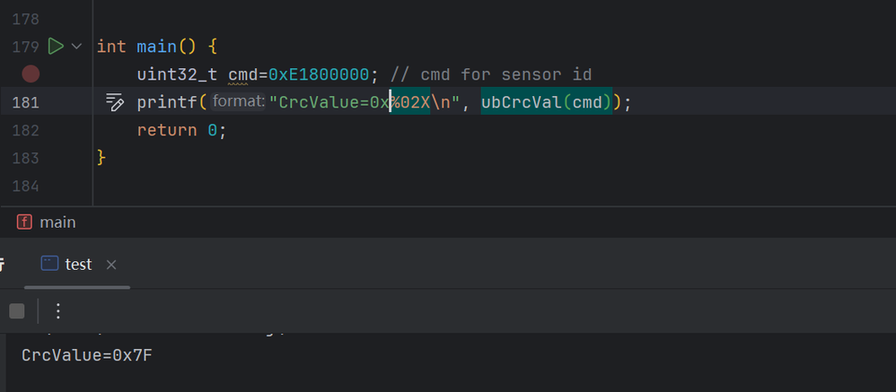

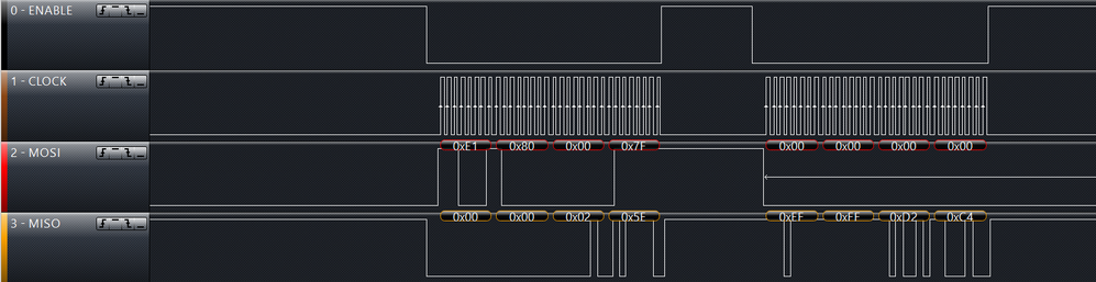

微信图片_2025-10-08_090139_754.png微信图片_2025-10-08_094543_846.png微信图片_2025-10-08_094627_918.pngReferring to the technical manual, in order to read the device ID, I sent the following data. Could you please check if it is correct? Thank you very much for your help!
