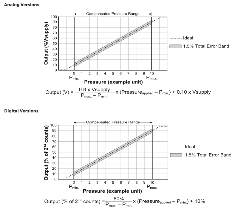

I am working on ABPDLNN100MG2A3 pressure sensor from honeywell which is an i2c communication, i have read the sensor data through i2c and saved it in two variable a and b the issue is how to convert the raw data to millibar, any thoughts kindly share.

Hi @NJP.1​ ,
please note that the ABPDLNN100MG2A3 is not an ST sensor.
But you should use the equation suggested in the datasheet you posted:
-Eleon
