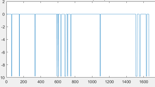

Sensortile kit is used and linear acceleration is fused output from gyroscope and accelerometer,the sensor is kept with z-axis of accelerometer being parallel to gravity (screenshot attached).

Hi @MAhm.1,
As far as I know the linear acceleration output from MotionDI should be without gravitational acceleration. Could you please send me your datalog that would include timestamp, acc & gyr & mag data and your calculated results? Attached is the example of the datalog format that would help a lot.
