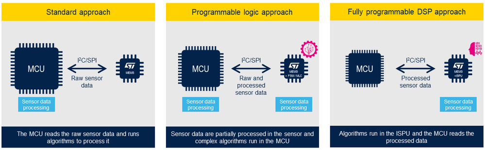

ST MEMS motion sensors have two types of embedded features. Both features mainly focus on running data processing in the sensor instead of the MCU. This results in a lower power consumption of the system. Embedded configurable features (for example, wake-up, free-fall, 4D/6D orientation) are present in the majority of our motion sensors. It is possible to adjust them mainly using threshold and duration. However, these features are only configurable, as the name suggests, and it is not possible to program a custom data processing. Recent ST MEMS motion sensors embed programmable features like Finite State Machine (FSM), machine learning core (MLC) or intelligent sensor processing unit (ISPU) to incorporate custom data processing into the sensor. Knowing this, we have 3 main approaches to run a custom embedded data processing based on sensor data described in the list and picture below:
  • Standard approach - MCU reads raw data provided by the sensor and desired processing is done inside the MCU,
  • Programmable logic approach - targets the lowest power consumption on a specific processing model. MCU reads the model results and possibly raw data when an interrupt is triggered,
  • Fully programmable DSP approach - any custom code (considering the computational and compiler limits) can be run inside the sensor and MCU reads processed data out of the sensor.

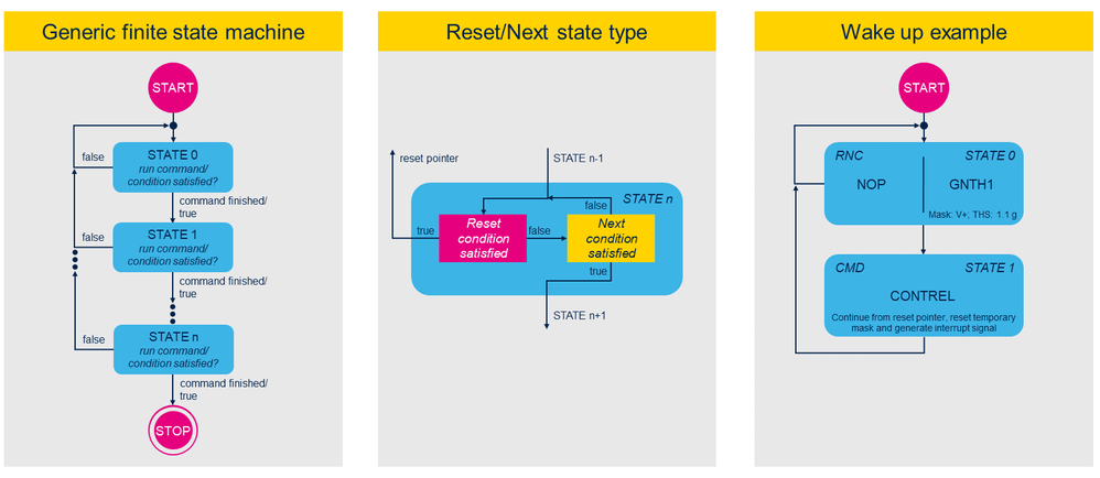

A Finite State Machine is a behavioral model composed of finite number of states with specific transitions between states, which are similar to a flow chart able to process both internal and external data (if sensor hub is available). There are two types of states - Reset/Next Condition (RNC) and command (CMD). The RNC type of state is composed of two conditions, one to reset the state machine and one to continue the program flow. The detailed description of the RNC state is shown in the picture below. The first condition evaluated is reset. If the result is true, the state machine is reset, otherwise next condition is evaluated. The flow continues to next state if the next condition was satisfied, otherwise the flow is paused until next sample arrives and the evaluation (both reset and next condition) is performed with a new sample. The examples of conditions for Reset/Next state types are: no operation, timers, comparison to thresholds, etc. The second type of state (CMD) executes a command to modify the program behavior in terms of flow control and output. The examples of commands are: stop execution, reset pointer set/reset, etc. An interrupt of FSM is generated when the end state is reached or when some specific command is performed. It is possible to run multiple state machines in parallel. In the picture below a simple wake-up example based on accelerometer data is shown.
The Finite State Machine approach is most suitable for applications, where a user-defined gesture pattern needs to be recognized.

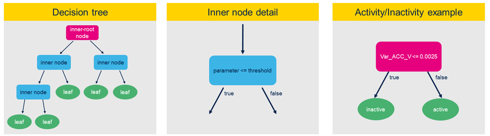

The machine learning core is composed of a set of configurable parameters (also called features) and decision trees. A decision tree is represented as a binary tree composed from two types of nodes - inner nodes and leaves. Inner node of a decision tree is a node, which has child nodes. Since the decision tree inside the MLC is a binary tree, the number of children is two. Inner nodes represent a part of decision tree, where a statistical parameter automatically calculated from raw sensor data is compared to a threshold (if-then-else) in order to choose next path, which can be either a true or false path. A leaf node of decision tree is a node, which does not have any children nodes and contains one of user defined classes - result. A brief description of a decision tree with an Activity/Inactivity example using only accelerometer data can be seen in picture below.
The statistical parameters, which are compared against a threshold within inner nodes of a decision tree, are parameters selected by the user (for example, mean, variance, etc.) in defined time window from available sensor data - both internal and external data (if sensor hub is available).

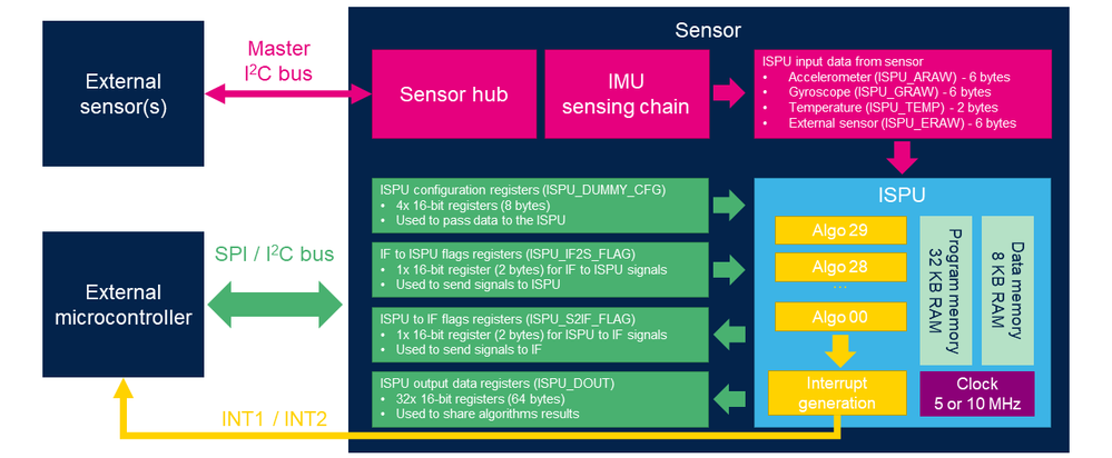

The ISPU is a compact, ultra low-power and high-performance programmable core based on the STRED architecture, a proprietary architecture developed by STMicroelectronics. This core allows processing both internal (accelerometer, gyroscope and temperature) and external (connected through sensor hub to the sensor) data in up to 30 separate, user defined algorithms. The algorithms are executed each time a new set of data is sampled starting from algorithm 29 down to algorithm 0. The ISPU is supported by two separate RAMs - 32 KB for code and 8 KB for variable data and the clock can be set to run either at 5 or 10 MHz.
The picture below contains a scheme describing the processing of data and connection of sensor to microcontroller and external sensors.
The ISPU can run C language algorithms that can be compiled by ISPU toolchain. The st-mems-ispu GitHub repository includes examples (including calibration algorithms, sensor fusion, wrist solutions, etc.) ready to be evaluated and a blank template project to be used for a new custom embedded feature. For evaluation of ISPU configuration compiled by ISPU toolchain it is possible to use MEMS Studio for selected evaluation hardware. It is possible to optimize and compile edge AI models for ISPU thanks to STEdgeAI Core. STEdgeAI Core supports frameworks Keras, PyTorch™ exported to ONNX standard, etc.
