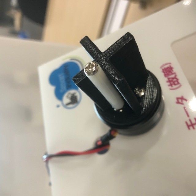

Ø  [Optional] Plastic Spacer of 7mm to create an unbalance.

The unbalanced condition is created simply by adding a spacer in one of the motor screw holes.

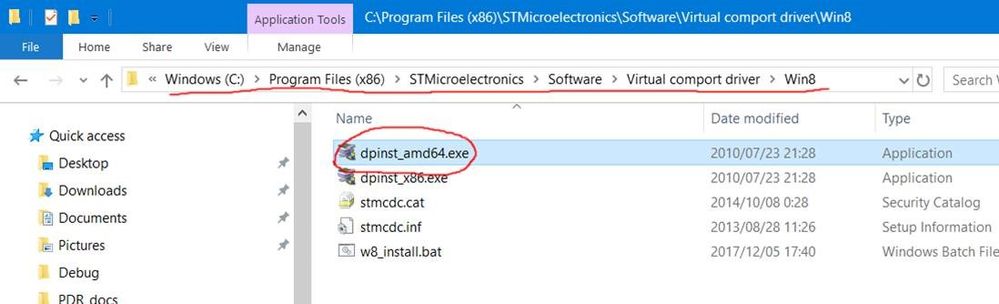

The installer program should also install the Virtual COM driver for the PC, in order to can connect the SensorTile.box to the PC via USB cable and seen as a COM port. If any issue with the driver after the installation, please proceed to install manually launching the driver installer from the following path:

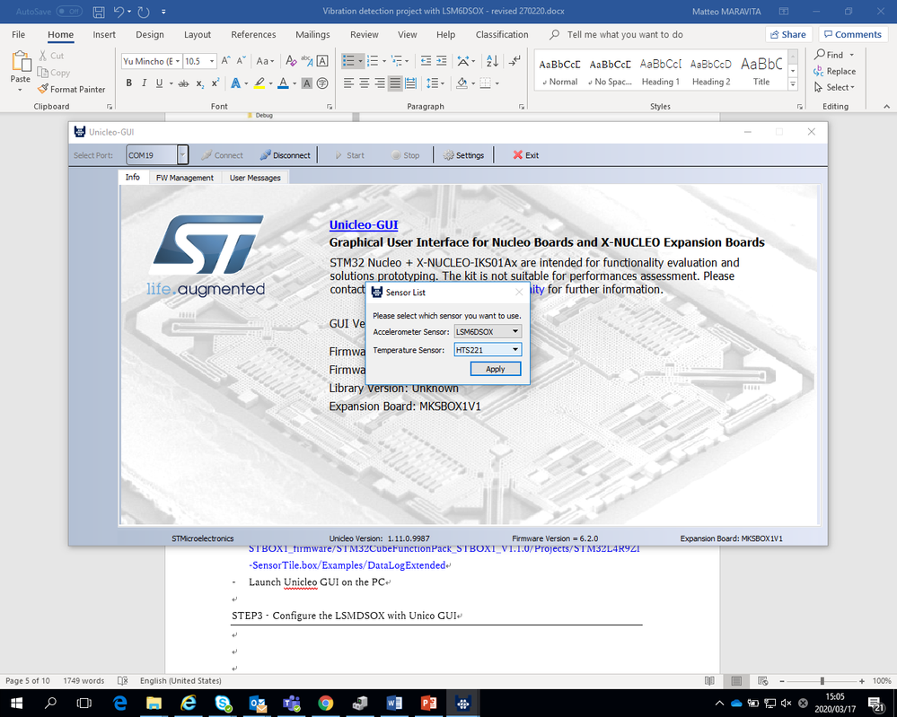

Ø  Launch Unicleo GUI on the PC and click on button Connect and Apply:

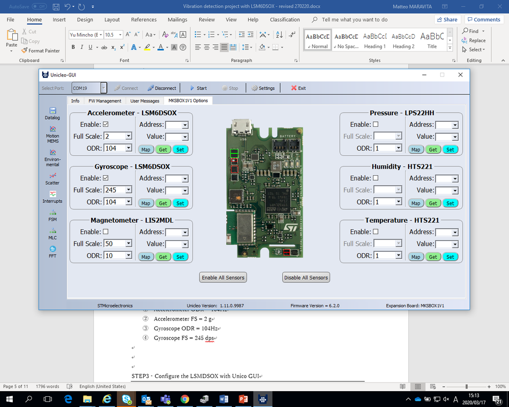

Ø  Enable Accelerometer and Gyroscope sensors and configure the following settings:
Accelerometer ODR = 104Hz
Accelerometer FS = 2g
Gyroscope ODR = 104Hz
Gyroscope FS = 245dps

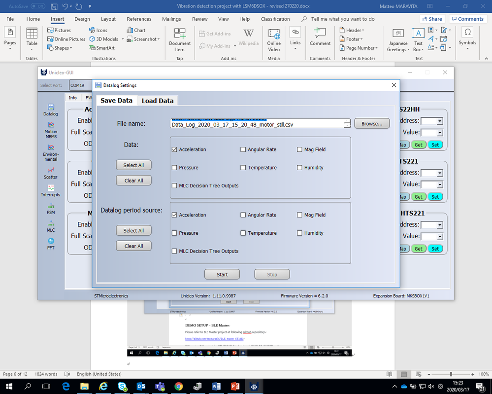

Ø  Click on the Datalog tab
Ø  Enable Accelerometer in the Data and Datalog period source tabs
Ø  Decide a meaningful name for the data log file. It should be easy later to understand the class from the file name.
Ø  Click on Start button
Ø  Wait few seconds to log enough data samples and then click Stop.
Ø  Repeat the procedure few times for each class, in order to create the desired dataset.

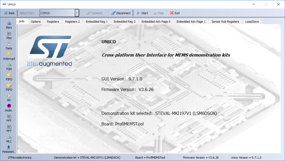

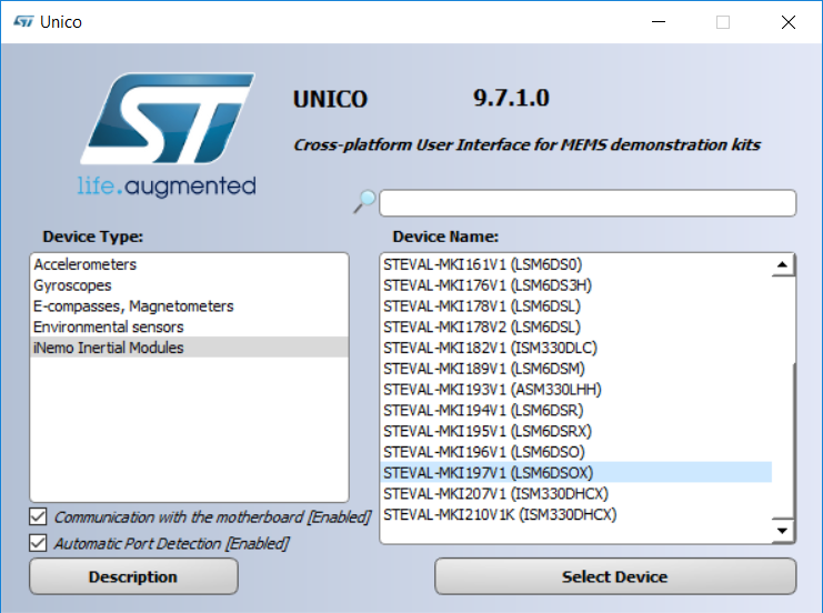

Ø  Connect to the PC the STEVAL-MKI109V3 + STEVAL-MKI197V1 boards with a USB cable, open the Unico GUI and select the iNemo Inertial Modules >> STEVAL-MKI197V1:

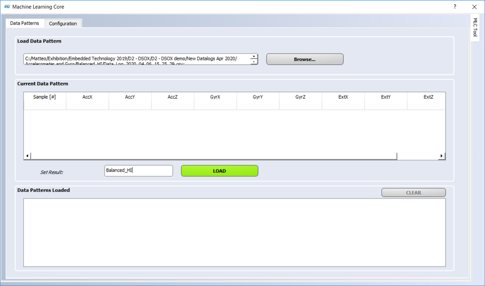

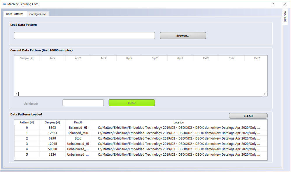

Ø  Select MLC Tab, start loading all the .csv log files relative to one class, assign a “Result” name (name of the class that will be identified) and push the “Load button”. The Unico GUI will import all the RAW data and split automatically between ACC and GYR data.
Ø  Repeat the same operation for the other classes to be identified

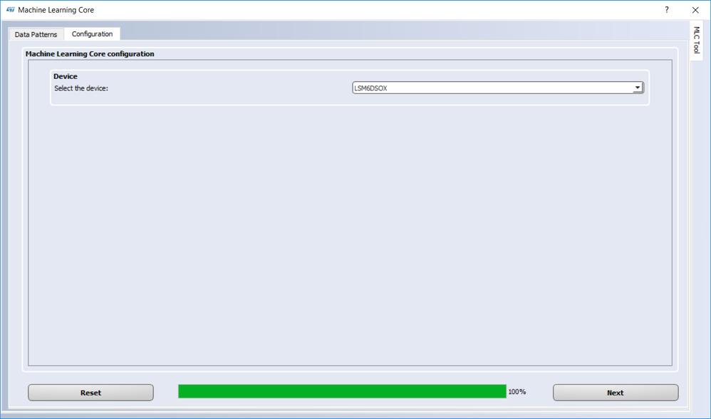

Ø  Configure the parameters in the Configuration tab: iNemo Inertial Modules >> STEVAL-MKI197V1:
Ø  Configure the Accelerometer and Gyroscope settings as following:
Machine Learning Core: 104Hz
Accelerometer: Full scale 2g, ODR 104Hz
Number of Decision trees: 1
Window length: 208 samples (104Hz, 2sec)

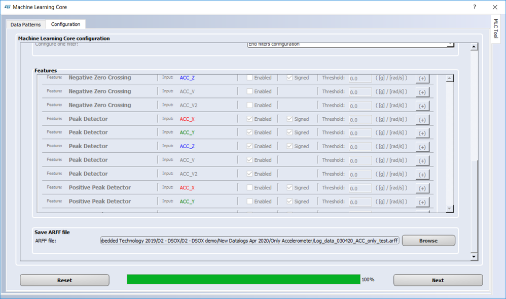

Ø  Configure the Features as following:
Variance (AX,AY,AZ,AV,AV^2, GX,GY,GZ,GV,GV^2).
HP Filtered Energy (AX,AY,AZ,AV,AV^2, GX,GY,GZ,GV,GV^2).
Peak to Peak (AX,AY,AZ,AV,AV^2, GX,GY,GZ,GV,GV^2).
HP Filtered Peak Detector (AX,AY,AZ,AV,AV^2, GX,GY,GZ,GV,GV^2).
Ø  Save the .ARFF file in a desired folder.
