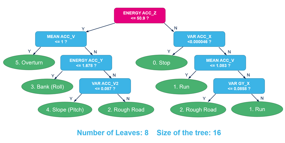

The resulting decision tree is shown in the figure below.
To obtain this decision tree, we have referred to the guidelines described in DT0139. In other words, we did a data check, a cleaning to eliminate error data and a visual check manually. But no optimization, such as pruning, is carried out due to time and resource constraints.

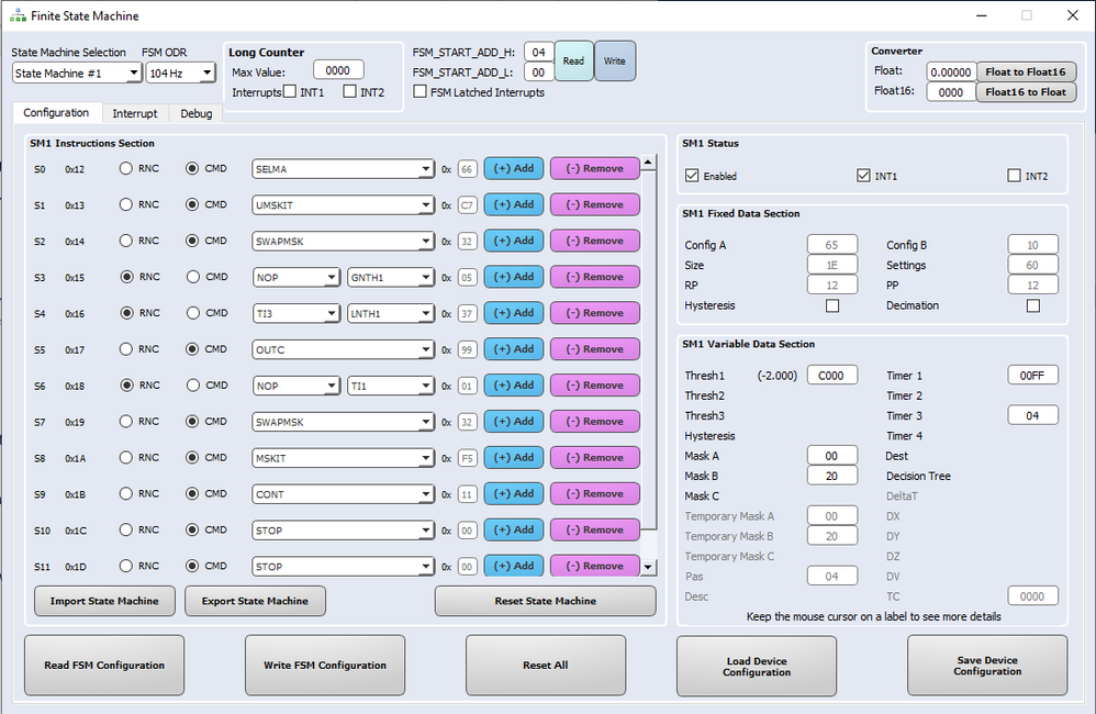

We also implemented accident detection on the front-end of the RC car in the FSM, because the FSM is better suited to detect short-term events such as accidents than the MLC.
This figure shows the accident detection parameters we defined for the demo using Unico-GUI for the FSM.
The axis to be detected is only +Y, and the threshold is set to -2[g], whose value was determined by trial and error.
To automatically clear the output register of the FSM after a few seconds, the firmware has some additional command and timer settings in addition to the main part for shock detection.

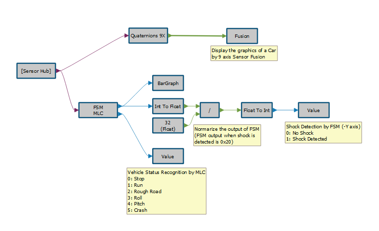

5. Generating firmware for STM32
To implement the MLC and FSM configuration, we developed firmware for STM32L4R9, which is the host MCU of the STWIN kit. The following figure shows the algorithm block diagram of the firmware we made using AlgoBuilder.
"STWIN BLE” was selected as the target board in the “Firmware Settings” dialog box of AlgoBuilder.

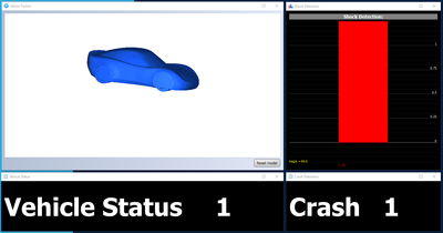

The firmware generated by AlgoBuilder is uploaded to the STWIN kit as described above, so that the output can be seen in Unicleo-GUI as shown in the figure below.
The 3D graphics of the blue car show the result of 9-axis sensor fusion computed by the STM32 library. The number appearing in the “Vehicle Status” box shows the output of the MLC described in Section 3, while the red bar and the number appearing in the “Crash” box displays the output of the FSM described in Section 4.

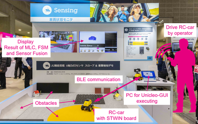

6. Demonstration at the automotive exhibition
The prepared demonstration system is shown in the picture below:
The STWIN kit sends the calculated data and detected status of the RC car in real time via Bluetooth® to the PC Unicleo-GUI. Then the Unicleo-GUI displays the received data/status graphically.

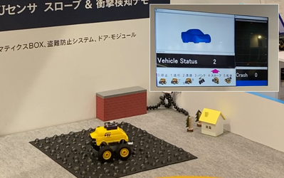

The RC car was remotely controlled by us in a 2m x 2m area, where there were some obstacles such as slopes, banks, walls, and rough surfaces.
Let us see together how this demo kit worked at the exhibition.
The following pictures show some cases of the RC car’s position and the outputs of the demo firmware, which were recognized by the MLC and FSM.

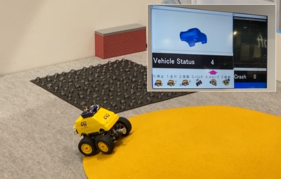

When the RC car is piloted over the bumped area, then the “Vehicle status” shows “2” (i.e. rough road status) on the screen as defined in Section 1.

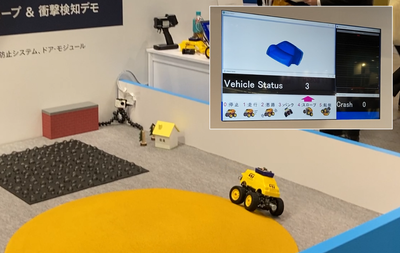

If the RC car is tilted to the left (or right), then “Vehicle status” shows “3” (i.e. on bank status) correctly on Unicleo-GUI.
When the RC car is climbing or descending the slope, then “Vehicle status” shows “4” (i.e. on a slope) correctly (same for the rear-end of the car).

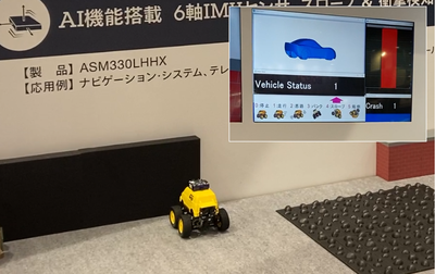

If the RC car hits the wall from the front-end, then Unicleo-GUI shows a red bar and the status of “Crash” becomes “1” (i.e. stop status) detected by the FSM.
The demo worked successfully during the show and proved to be effective. In fact, many visitors stopped to watch it and asked many questions, also providing feedback.
