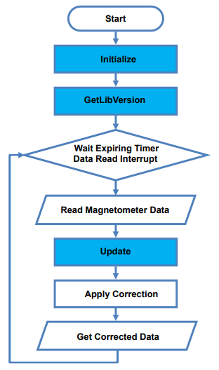

The MotionMC library acquires data from the magnetometer and features the hard iron compensation, theoretically unlimited (within sensor range) and a wide scale factor compensation range from 0.65 to 1.35 in every direction.
The two central functions for the MotionMC manage the magnetometer parameters calibration and are the following ones:
>> void MotionMC_Update (MMC_Input_t *data_in)
>> void MotionMC_GetCalParams (MMC_Output_t *data_out)
where the input data *data_in is a structure composed from:
  • Mag[3] is an array of magnetometer sensor value in µT
  • TimeStamp parameter is the timestamp value in ms for current magnetometer sensor data
and the output data *data_out is also a structured of:
  • HI_Bias[3] is an array of magnetometer hard iron (HI) coefficients in µT
  • SF_Matrix[3][3] is a 3x3 matrix of magnetometer scale factor (SF) coefficients
  • CalQuality is the calibration quality factor
See below the typical flowchart of the MotionMC calibration procedure :fast_down_button:
