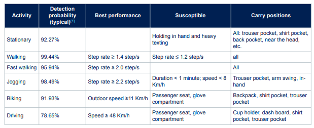

MotionAR library provides real-time information on the type of activity you are performing. It is able to distinguish and classify among the following activities: no activity (0), stationary (1), walking (2), fast walking (3), jogging (4), biking (5), driving (6), managing the data acquired from accelerometer.
2.Calibration Algorithm
The library is based on accelerometer data only, and requires a data sampling frequency of 16 Hz., and can to distinguish among the following activities: stationary, walking, fast walking, jogging, biking, driving.

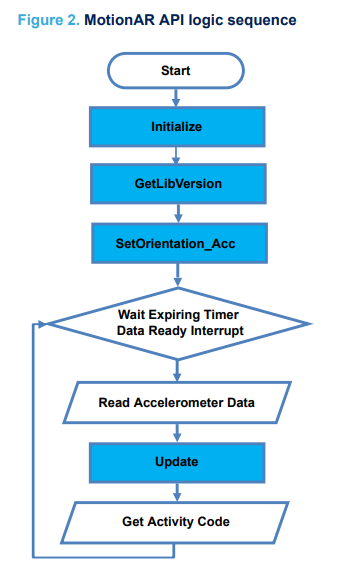

The central function that performs the activity recognition is this one:
void MotionAR_Update (MAC_input_t *data_in, MAR_output_t *data_out, long int timestamp)
*data_in parameter is a pointer to a structure with input data, *data_out parameter is a pointer to enum with the items described in the previous post and timestamp variable is a relative time for actual sample in ms.
See below the detailed output of the activity recognition of MotionAR algorithm! :fast_down_button:
