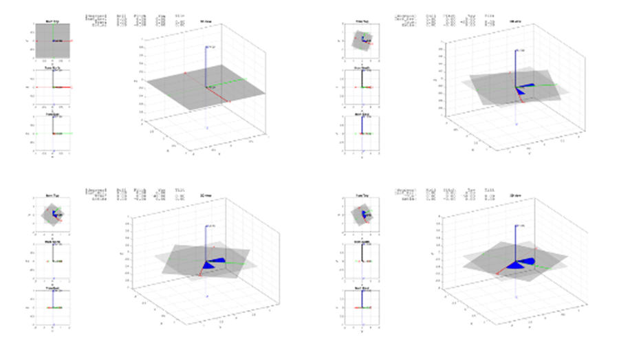

In general, any accelerometer inclination can be obtained as a sequence of two rotations. Using the flight dynamic conventions, axes named according to standard DIN 9300, the first is a rotation around the Y-axis (also known as pitch, which causes the X and Z axes to move, range ±90 degrees), the second is a rotation around the X-axis (also known as roll, which causes the Y and Z to move, range ±180 degrees). Note that the Android platform has a different naming convention: the first is a rotation around the Y-axis, parallel to the left and right edge of the smartphone (this rotation is defined as roll, range ±90 degrees), the second is a rotation around the X-axis, parallel to the bottom and top edge (this rotation is defined as pitch, range ±180 degrees).

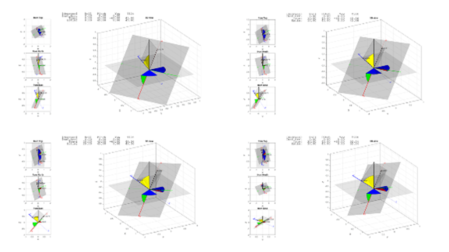

In the picture below the pitch angle is set to 0, +15, +30, +45 degrees going from left to right. Pitch is a rotation around the Y-axis therefore the AccY measurement does not change. The AccZ and AccX measurements are mathematically linked to the pitch angle: AccZ = cos(pitch angle) x 1 g and AccX = sin(pitch angle) x 1 g. The pitch angle is defined as the angle between the horizontal plane and the X-axis of the accelerometer; it is highlighted in green in the pictures below. The range is from -90 to +90 degrees. See also Design Tip DT0140 for more information on how to compute tilt angle.
In the picture below the roll angle is set to 0, +10, +20, +30 degrees going from left to right. Roll is a rotation around the X-axis therefore the AccX measurement does not change. AccY = sin(roll) cos(pitch) x 1 g and AccZ = cos(roll) cos(pitch) x 1 g. Note that the tilt angle will be affected by both roll and pitch: AccZ = cos(tilt) x 1 g = cos(roll) cos(pitch) x 1 g, the tilt angle is identical to roll angle only if pitch is 0 degrees (rotation constrained around X), or it is identical to pitch angle only if roll is 0 degrees (rotation constrained around Y).

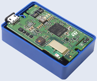

The SensorTile.box multisensor kit is used in this tutorial and in particular the LSM6DSOX sensor. The same procedure shown here also applies to other ST sensors equipped with the machine learning core.

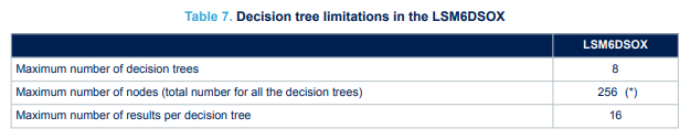

  • N number of intervals, leaves of the decision tree. The maximum number of intervals depends on the device. Example: N=16 for LSM6DSOX.

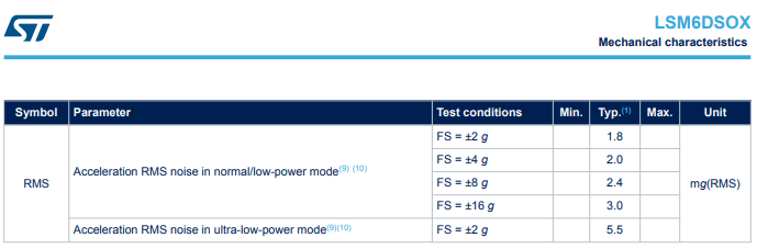

  • RMS noise value: this value is available from the sensor datasheet. If the noise density is specified, then compute RMS = Noise Density x sqrt(bandwidth), where bandwidth depends on the configured lowpass filter, when no lowpass filter is configured the bandwidth = output data rate / 2. If it is specified, the C utility can verify which interval is prone to misclassification: if the distance to the threshold is less than 3 x RMS level, then the risk is larger than 0.4% and the interval will be flagged with an asterisk in the console output.

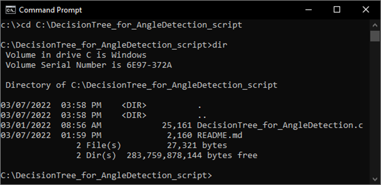

Open the Windows Command Prompt (for example, press Win+R, type cmd and press the Enter key) and go to the folder where the DecisionTree_for_AngleDetection.c is located. For instance, if the file is located in
"C:\DecisionTree_for_AngleDetection_script", then you can use the following command:
cd C:\DecisionTree_for_AngleDetection_script
The correct location can be verified by writing the command dir or ls as shown in the picture below (the DecisionTree_for_AngleDetection.c must be listed):
Execute the following command to build the DecisionTree_for_AngleDetection.c:
gcc DecisionTree_for_AngleDetection.c -lm -o DecisionTree_for_AngleDetection
The command creates an executable file in the current folder (in this case "DecisionTree_for_AngleDetection.exe"). Under Windows the .exe extension is automatically appended to the executable name.

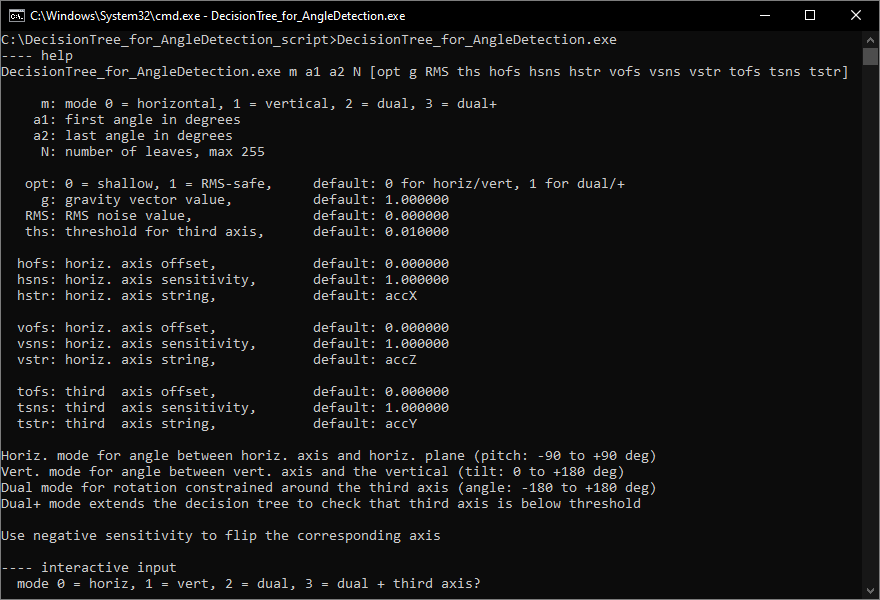

After building the program, it can be run with the following command: "DecisionTree_for_AngleDetection.exe"
If no parameter is used, the program opens in interactive mode and the user need to input the parameters to configure the Decision Tree. The fist parameter that needs to be selected is the mode of the angle detection.
For this example, we will select mode 2 that configures the Decision Tree to detect rotation constrained around the 3rd axis within a given range. The program will then ask for the following information:
  • first angle (in this tutorial set to -40 deg). It must be an integer in the range of -180 to 180 [deg].
  • last angle (in this tutorial set to 100 deg). It must be an integer in the range of -180 to 180 [deg]. This angle must be greater than the first angle
  • number of leaves (in this tutorial set to 16). It must be an integer in the range 2-255. The number of leaves is limited by the "Maximum number of results per decision tree" of the sensor. For the LSM6DSOX, the maximum number is 16:
  • opt (in this tutorial set to 1). The value for determining the use of a shallow tree (0) or noise safe tree(1).
  • g (in this tutorial set to 1). The value corresponding to 1g depends on the sensor model.
  • RMS noise (in this tutorial set to 0.0018). It must be the value of the RMS noise reported on the datasheet for the selected full scale. For the LSM6DSOX, the acceleration RMS noise in normal/low-power mode is 1.8 mg (0.0018 g):
In this tutorial inputs will be as shown in picture below:

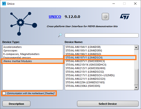

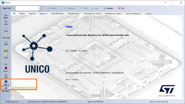

Once the decision tree files are generated by the DecisionTree_for_AngleDetection.exe program, open the Unico-GUI software tool and select the "iNEMO Inertial Modules" from the list of Device Type and then select the "STEVAL-MKI197V1 (LSM6DSOX)" item from the list of Device Names. You do not need to have the board, but there you find the LSM6DSOX MEMS device. The "Communication with the motherboard [Enabled]" option box must be unchecked to enable the offline mode (no hardware is required). Then click on the "Select Device" button or double click "STEVAL-MKI197V1 (LSM6DSOX)".
Confirm the message about limited functionality (only if the offline mode was selected) and open the MLC window:

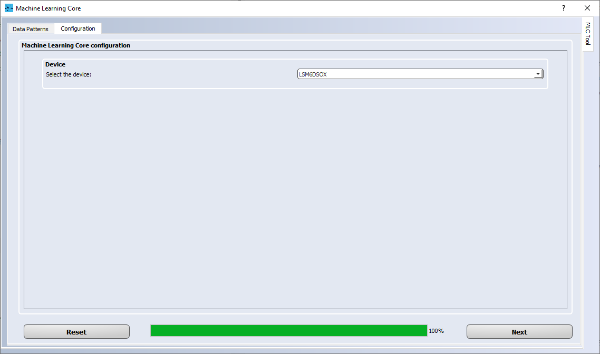

Open the machine learning core tab by clicking the MLC button:
Go directly to the Configuration tab:

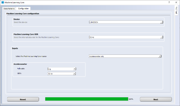

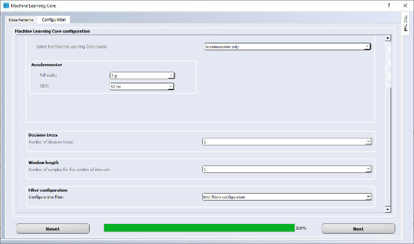

Select LSM6DSOX and choose the required parameters of the MLC and sensor. The chosen configuration of the sensor and MLC output data rate (ODR) for this tutorial is visible in the picture below:
Select one decision tree from the list and continue configuring the MLC. The Window Length should be configured to 1 sample to minimize the latency, the output is updated on each sample. In this example the ODR is set to 52Hz, therefore the output is updated 52 times a second, every 19.23 ms. A longer window can be used for a less frequent but more stable output because the mean feature is selected below:

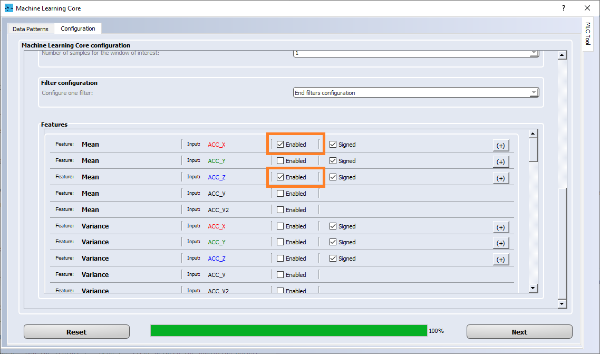

In the next step, check the Mean feature for the accelerometer X axis (ACC_X) and Z axis (ACC_Z):

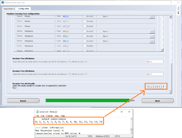

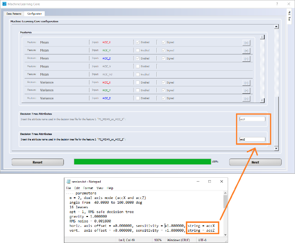

In the next section it is required to provide the Decision Tree Attributes names for each feature. The generated decision tree session file (session.txt) contains the names that need to be used:

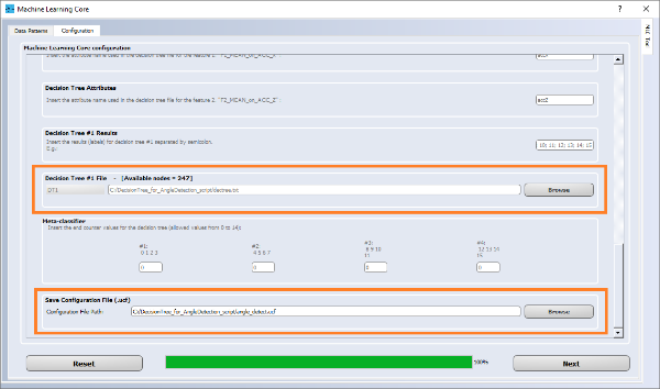

Once the attribute name is copied, the Results labels must be copied as well from the decision tree session file as follows:
The next steps are to import the decision tree generated with the program (dectree.txt) and select the output name for the .ucf configuration file to be saved:
At this point, the .ucf file has been generated and the Unico-GUI can be closed.

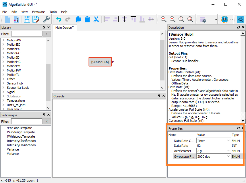

To test the .ucf file created with Unico-GUI in this tutorial, we create a project with AlgoBuilder. Open AlgoBuilder and click on File -> New Design. From the firmware Settings window select the firmware location, the Toolchain, and the Target platform as in picture below:
Since the ODR of the accelerometer and the ODR of the machine learning core has been set up to 52 Hz in Unico-GUI, then in the [Sensor Hub] building block we need to set the Data Rate to 52 Hz as well. To change the configuration, click on the [Sensor Hub] building block and configure it as in picture below:

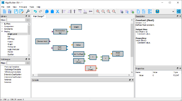

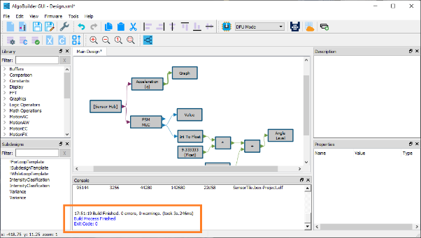

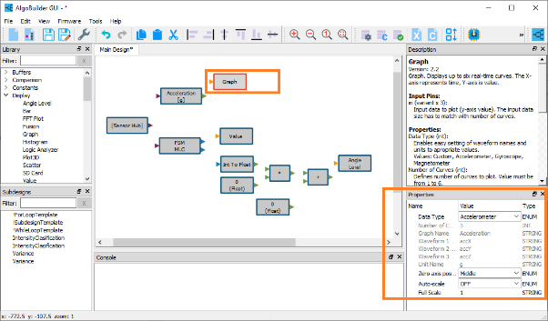

At this point we need to drag-and-drop all the building blocks that are needed to build the example project. From the left list, simply drag-and-drop all the block needed which are:
1x Sensor Hub -> Acceleration [g] 1x Sensor Hub -> FSM / MLC 1x Display -> Graph 1x Display -> Value 1x Other -> Int to Float 2x Constants -> Constant (Float) 1x Math Operators -> Multiply (*) 1x Math Operators -> Add (+) 1x Display -> Angle Level.
The blocks should be placed as in picture below:

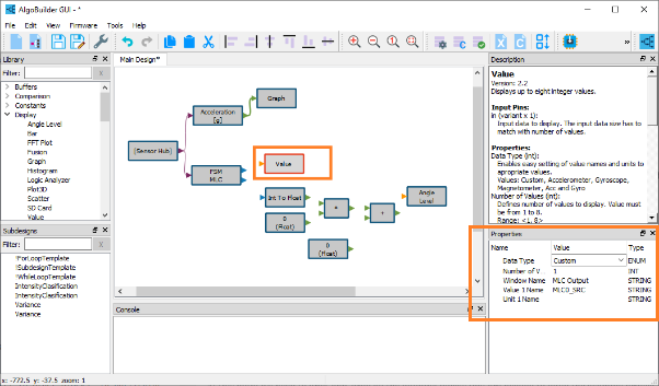

Some display block must be configured properly before it can be connected to other blocks, because input/output types between connected blocks must match; please see following picture to configure them properly:

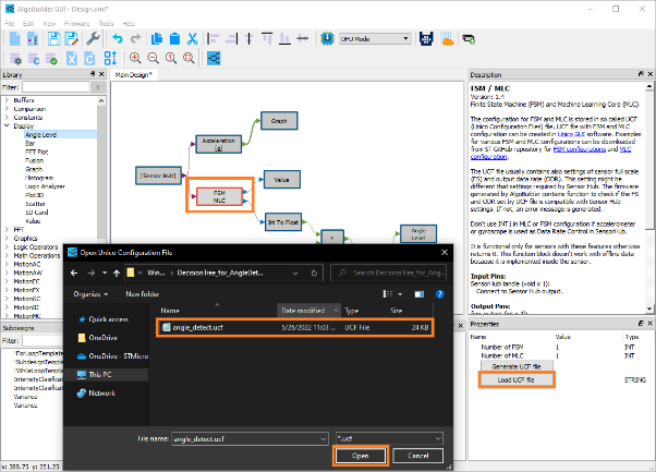

Import the .ucf file by selecting the FSM/MLC building block, as in picture below:

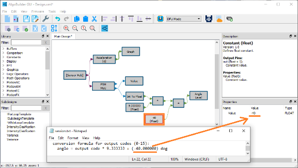

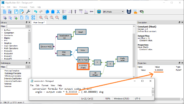

The multiplication and the sum blocks have been placed to implement the computation of the angle from the value of the machine learning core output register. The formula can be found in the session.txt in the section called angles and conversion formula, as shown below:

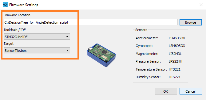

On the top menu, click on firmware -> Generate C Code. After C Code generation is completed, click on firmware -> Build firmware. If there is any error, the compilation should complete successfully as in picture below:

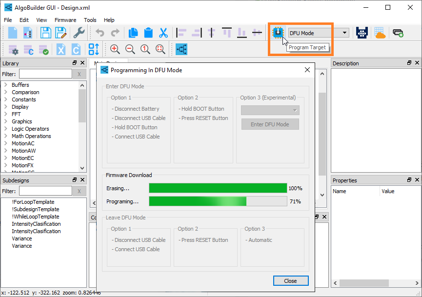

5. Programming SensorTile.box

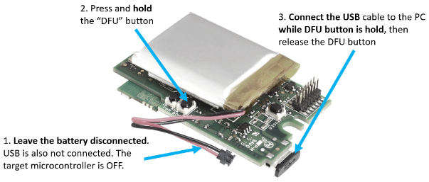

The SensorTile.box must be in DFU (Direct firmware Upgrade) mode before it can be programmed: disconnect the battery, press and hold the boot button, plug to USB to power the target microcontroller.
At this point, click Program Target in AlgoBuilder GUI as shown in the picture.
The AlgoBuilder should detect the SensorTile.box and program the binary generated. AlgoBuilder can be closed.

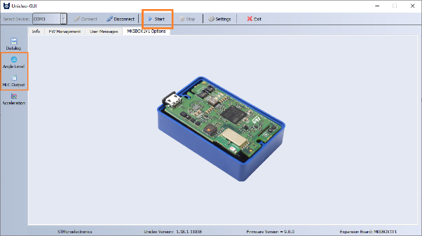

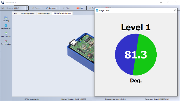

Open the Unicleo-GUI software. The software should automatically detect and connect to the SensorTile.box Press the Start button to start the streaming from the SensorTile.box.
To see the detected Angle, click on the Angle level on the left panel. Move the board within +/-6 degrees respect to the horizon to see the variation detected in real time.

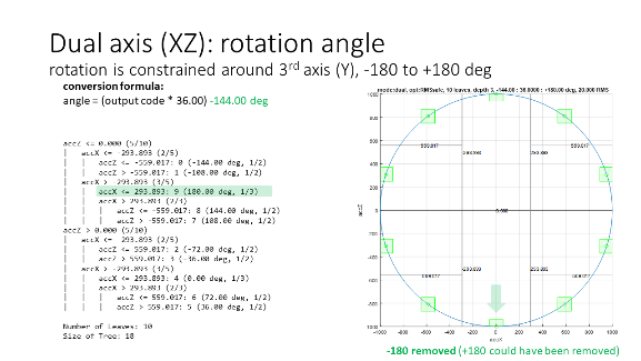

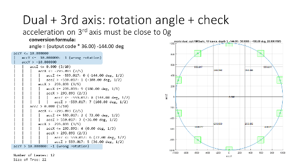

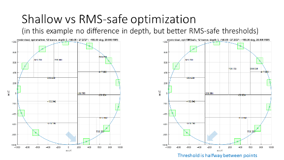

Decision tree examples–Dual Axis Mode

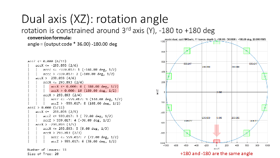

The dual axis mode supports the full rotation range, from -180 to +180 degrees. These two angles however represent the same orientation (the "upside-down" position). If one wants to detect on which side the upside-down position is, for example, -179.9 or +179.9 degrees, then the following decision tree is to be used. Otherwise, it is better to either remove -180 or remove +180, so that the output code does not oscillate between the two values when the device is in the upside position.
The dual+ mode can be selected to use the third axis (Y) when it is available and check that the rotation is indeed constrained (abs(Y) < threshold). The decision tree can be simplified by using the absolute value of the selected feature for AccY.

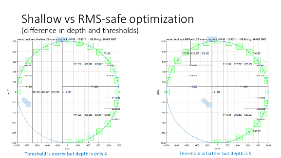

The optimization mode can provide shallower trees or decision thresholds, which are farther from the interval centers, giving more robustness against RMS noise. RMS noise can always be reduced by selecting longer windows to compute the mean feature and by enabling a digital lowpass filter.

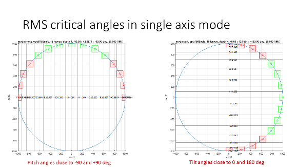

When the RMS noise level is specified, the intervals that may be subject to misclassification caused by noise are highlighted by an asterisk in the console output of the C utility and highlighted with red color in the picture below:
