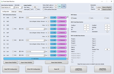

3. Configuring the FSM
We use three-state machines.
  • State machine 1 is used to configure the ASC when the MLC outputs the STILL state.
  • State machine 2 is used to configure the ASC when the MLC outputs the SHAKING state.
  • State machine 3 is used to configure the ASC when the MLC outputs the FASTMOVING state.
State machine 1 configuration:
  • S0 instruction is an RNC: NOP | CHKDT, configure the decision tree value to 0, used to check the MLC output value, if equal to 0, go to the next state.
  • S1 instruction is a CMD: SETR, used to enable the ASC feature.
  • S2 instruction is the device register address: 0x11, used to set the IMU CTRL2 register.
  • S3 instruction is Value:0x00, used to set the CTRL2 register value to 0x00, set the gyroscope to power-down.
  • S4 instruction is CMD: SETR, used to enable the ASC feature.
  • S5 instruction is the device register address: 0x10, used to set the IMU CTRL1 register.
  • S6 instruction is Value:0x44, used to set the CTRL1 register value to 0x44, set the accelerometer to low-power mode 1 and ODR to 30Hz.
  • S7 instruction is a CMD: SETR, used to enable the ASC feature.
  • S8 instruction is the device register address: 0x17, used to set the IMU CTRL8 register.
  • S9 instruction is Value:0x00, used to set the CTRL8 register value to 0x00, set the accelerometer FS to 2g.
  • S10 instruction is a CMD: CONTREL, used to reset the program.

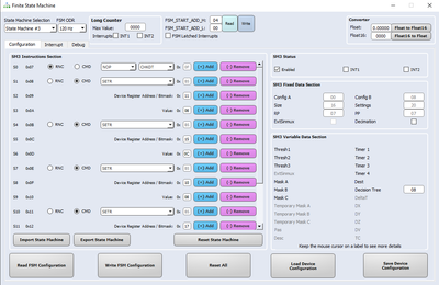

State machine 2 configuration:
  • S0 instruction is an RNC: NOP | CHKDT, configure the decision tree value 4, used to check the MLC output value, if equal to 4, go to the next state.
  • S3 instruction is Value:0x06, used to set the CTRL2 register value to 0x06, set the gyroscope to high-performance mode and ODR to 120Hz.
  • S5 instruction is the device register address: 0x15, used to set the IMU CTRL6 register.
  • S6 instruction is Value:0x00, used to set the CTRL6 register value to 0x00, set the gyroscope FS to 125dps.
  • S7 instruction is CMD: SETR, used to enable the ASC feature.
  • S8 instruction is the device register address: 0x10, used to set the IMU CTRL1 register.
  • S9 instruction is Value:0x06, used to set the CTRL1 register value to 0x06, set the accelerometer to high-performance mode and ODR to 120Hz.
  • S10 instruction is CMD: SETR, used to enable the ASC feature.
  • S11 instruction is the device register address: 0x17, used to set the IMU CTRL8 register.
  • S12 instruction is Value:0x01, used to set the CTRL8 register value to 0x01, set the accelerometer FS to 4g.
  • S13 instruction is a CMD: CONTREL, used to reset the program.
  • S14 instruction is a CMD: STOP, the end of the program.
State machine 3 configuration:
  • S0 instruction is an RNC: NOP | CHKDT, configure the decision tree value 8, used to check the MLC output value, if equal to 8, go to the next state.
  • S3 instruction is Value:0x06, used to set the CTRL2 register value to 0x08, set the gyroscope to high-performance mode and ODR to 480Hz.
  • S4 instruction is a CMD: SETR, used to enable the ASC feature.
  • S6 instruction is Value:0x0C, used to set the CTRL6 register value to 0x0C, set the gyroscope FS to 4000dps.
  • S9 instruction is Value:0x08, used to set the CTRL1 register value to 0x08, set the accelerometer to high-performance mode and ODR to 480Hz.
  • S10 instruction is a CMD: SETR, used to enable the ASC feature.
  • S12 instruction is Value:0x02, used to set three CTRL8 register value to 0x02, set the accelerometer FS to 8g.

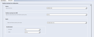

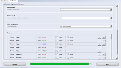

4. Configuring the MLC
Configuration parameters of the MLC
  •          MLC ODR: 120Hz
  •          Window length: 52 samples
  •          Filters: No
  •          Selected features:
  •          MEAN_on V and V2
  •          Meta classifier: No
Finally, the user is prompted to select the target UCF files and, by clicking next, it is automatically generated by Unico-GUI. Save it to the PC (for example, use the filename mlc.ucf).

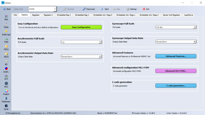

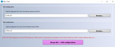

5. Merge MLC and FSM configurations
  • Select the advanced MLC+FSM button.
  • Load the MLC ucf file (for example, mlc.ucf)
  • Load the FSM ucf file (for example, fsm.ucf)
  • Click on the merge MLC + FSM configurations button and save it to the PC (for example, asc.ucf)

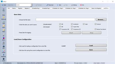

  • Select the load button to load the asc.ucf files to the evaluation board.

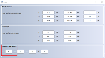

6. Demonstration on the evaluation board

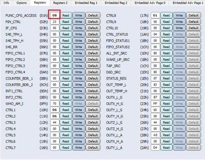

  • Enables the FSM to access the CTRL registers. Configure FUNC_CFG_ACCESS (01h) to 0x08.

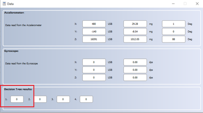

  • Data when the board is in STILL status, MLC output 0 and the ASC configures the IMU at XL ODR=30Hz,FS_XL=2g,gyroscope off, low-power mode:

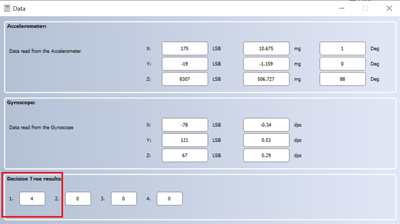

  • Data when the board is in SHAKING status, MLC output 4, and the ASC configures the IMU at XL ODR=120Hz,FS_XL=4g, gyroscope ODR=120Hz,FS_Gyro=125dps, high-performance mode:
  • Data when the board is in FASTMOVING status, MLC output 8, and the ASC configures the IMU at XL ODR=480Hz,FS_XL=8g,Gyro ODR=480Hz,FS_Gyro=4000dps, high-performance Mode.

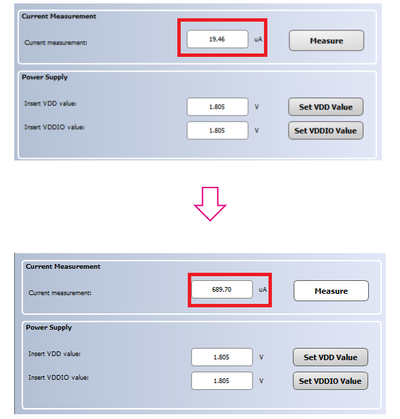

The result shows that when the device is in a STILL state, the current is 19.46 µA.
When the device is in a FASTMOVING state, the current is 689.70 µA.
