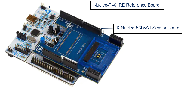

In this article the X-NUCLEO-53L1A1 and a NUCLEO-F401RE will be used as an example. Please check out the article

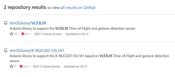

3.1. GitHub files download
Start by downloading two zip files from GitHub.
Figure 1Figure 1
The STM32duino/VL53L1X contains only the VL53L1X device Arduino Library. This library is required to be installed to allow to use the examples included in the next library.
The STM32duino/X-NUCLEO-53L1A1 contains the library supporting the expansion board (X-NUCLEO-53L1A1) and the examples.

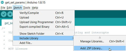

Once the two zip files are downloaded, click on Sketch/Include Library/Add ZIP Library and browse to the directory where the two ZIP files have been downloaded to install the two libraries.
Figure 2Figure 2

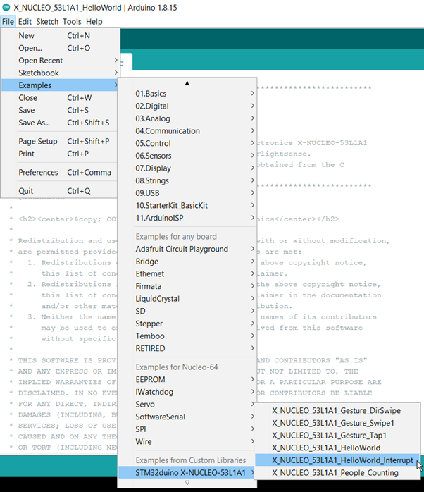

3.3. Load example sketch
Once both libraries are installed, click on File/Examples/STM32duino X-NUCLEO-53L1A1/STM32duino/X-NUCLEO-53L1A1_HelloWord_Interrupt to load the example sketch into the IDE.
Figure 3Figure 3

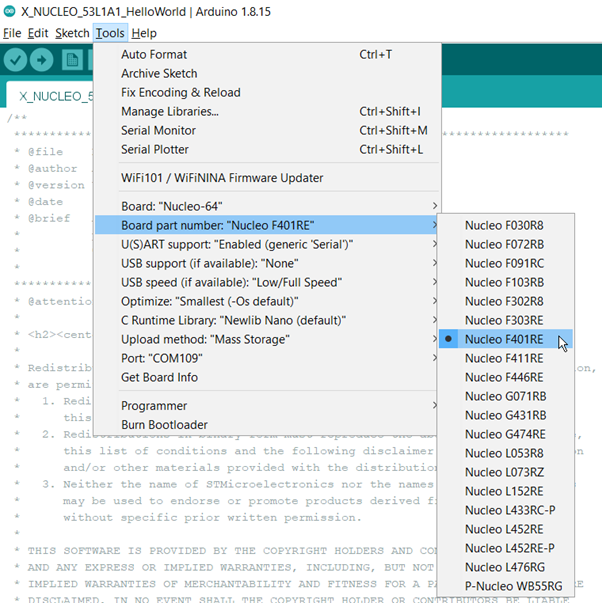

3.4. Select the Nucleo board
Select the right Nucleo board F401RE target.
Figure 4Figure 4

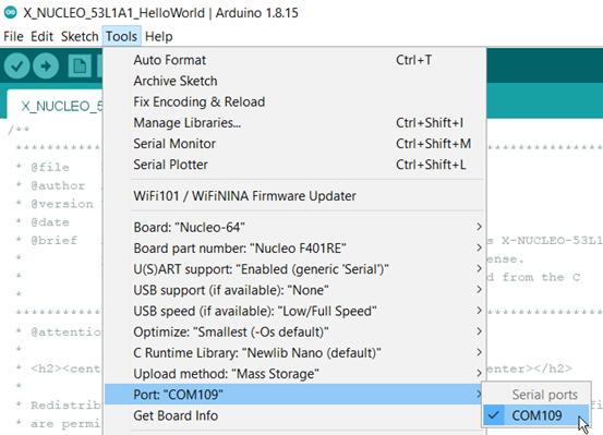

3.5. Select the right COM port
Figure 5Figure 5

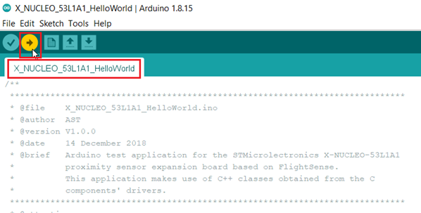

3.6. Compile and flash the Arduino board
Figure 6Figure 6

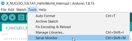

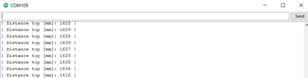

3.7. Open the serial monitor (fig 7)
Figure 7Figure 7
3.8. Result
The ranging result should be displayed on a serial terminal as shown in figure 8
Figure 8Figure 8
