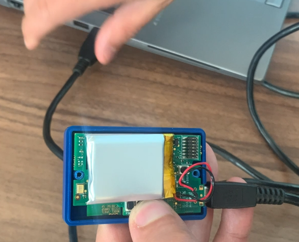

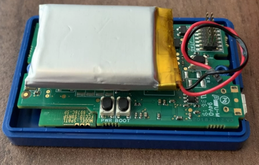

During this knowledge article, the board will be use in DFU mode. To enable this mode on the board it is needed to disconnect the board from the power supply
Then it is needed to press the “Boot” button and at the same time connecting the USB cable to the PC:

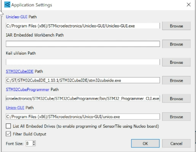

1. Configuration
As a first step launch the AlgoBuilder program and go on Application Settings and linking all the .exe files for:
  • Unicleo-GUI
  • STM32CubeIDE
  • STM32CubeProgrammer
  • Unico-GUI

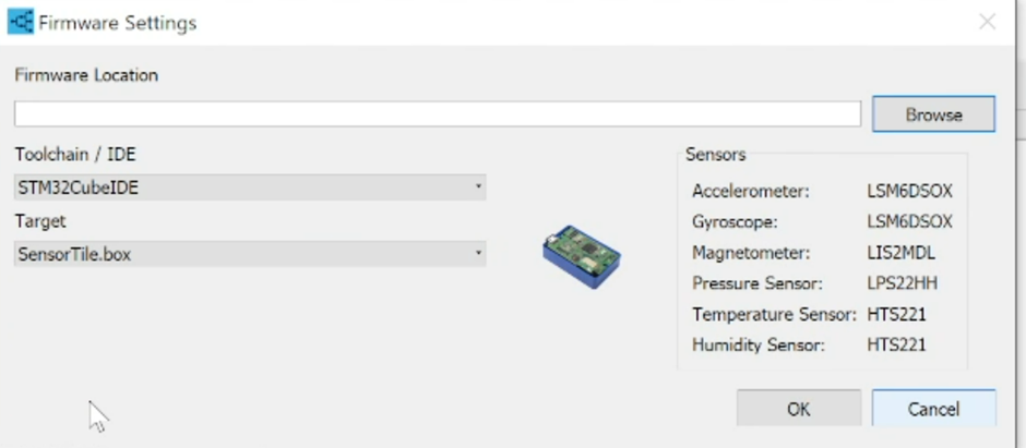

Then, it is needed to open the firmware settings selecting the project location, the toolchain will be selected automatically and finally the Target board to flash the firmware.
The target for this demo is the Sensotile.box.

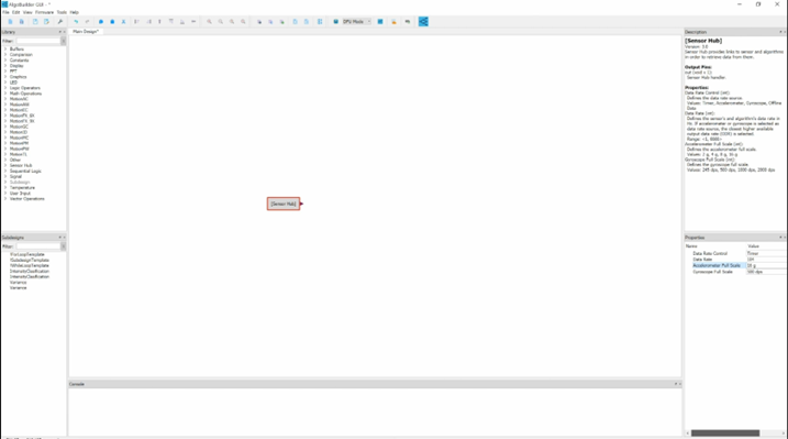

The first building block to use is the Sensor Hub block.
It is possible to change the properties of the AXL and the Gyro:
  • 104Hz for both AXL and Gyro
  • Accelerometer full scale: 16g
  • Gyroscope full scale: 500dps

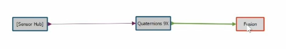

Since our target is to get Quaternion 9X data and displaying them with a 3D face, it is needed to bring two blocks in the AlgoBuilder:
The sensor fusion has different model to display 3D elements, it has a teapot, a car, a Nucleo Board, and a head. For this knowledge article linked to avatars in the metaverse, the head is the feature selected.

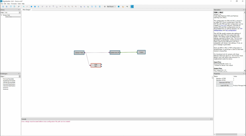

The next step is to get the .UCF file and implement it in the algorithm. To do so it is needed to select the MLC/FSM block and click on load .UCF file.
The data from the Sensor Hub will be analyzed by the MLC .UCF file we generated.

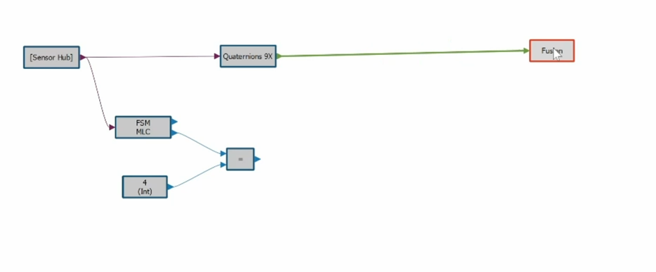

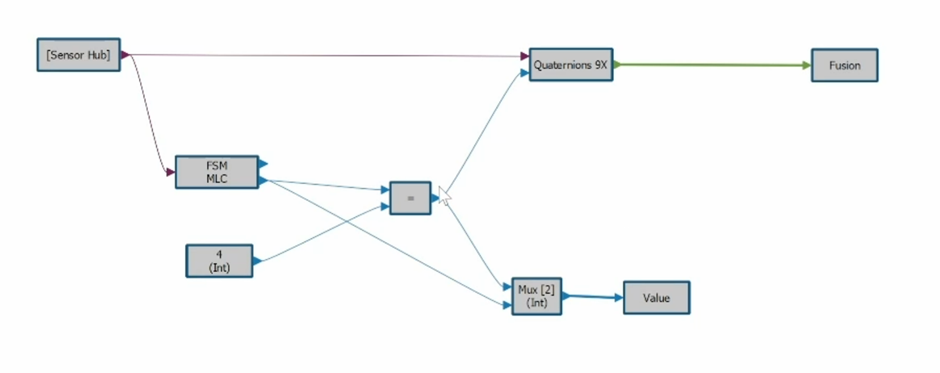

Since the goal is to activate the 9x quaternion when the MLC shows the Hat on position, it is needed to insert here some logic blocks:
First it is needed to put an integer block with and we set its value to 4. In the previous knowledge article we defined two classes the class 0 for when the hat is steady and the class 4 for when the hat in on someone’s head.
Comparing the MLC output with this integer value with an “equal” block the logic will return a 0 value if the MLC output doesn’t match with the value 4 and it will return a 1 value if on the contrary the MLC and the integer value match, hence they are both 4.

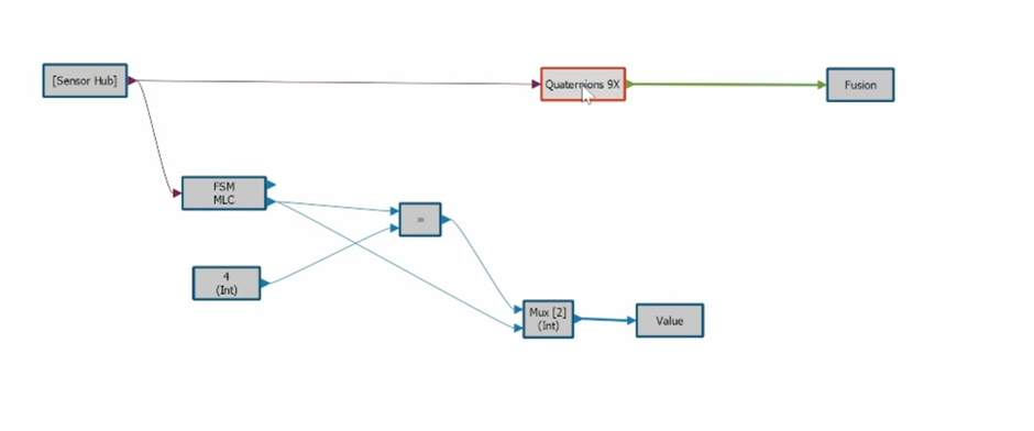

To check if the logic works well, it is needed to display two different integer output the one from the MLC and the one from the equal.
The next block to use is the Mux [2] block which gets as input two values
Finally, the display is done with the value block where it is needed to set some parameters:
  • Data Type: Custom
  • Number of Values: 2
  • Window name: Status
  • Value Name 1: Fusion On-Off
  • Value Name 2: Hat On_Off
If this way a status display will appear highlighting if the hat is on or off and if the sensor fusion is running.

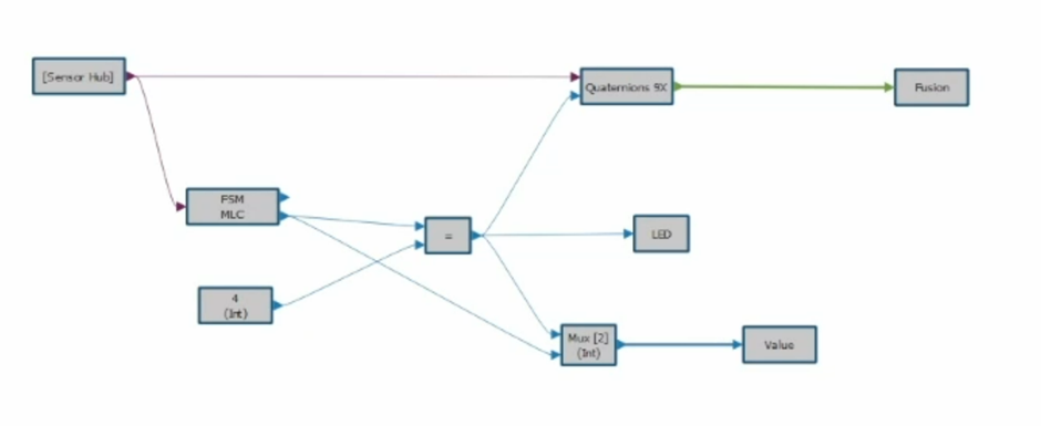

Finally, it is needed to connect the output of the equal block to the Quaternion 9x, in this way if the condition of the hat on is verified and the equal block output is 1 than the quaternion is activated and the fusion will display the moving avatar following the head movement.

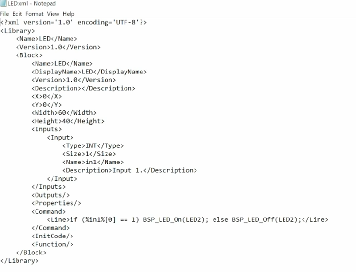

The very last step that is not mandatory, but can be useful is to add one more block to the algorithm leveraging the switch on/off of the LED present on the sensortile.box.
For that it is needed to write one line of code in .xml format and add it to AlgoBuilder libraries.
The code says that if the equal output is equal to 1 than the LED 2 turns on, otherwise the LED 2 is off. In this case the LED 2 is the green LED.
Once this is implemented it is possible to build the firmware and then flash it in the sensortile.box as shown in the previous part (link).

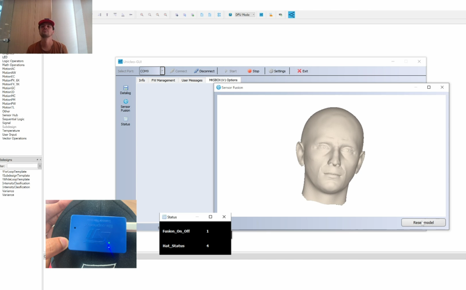

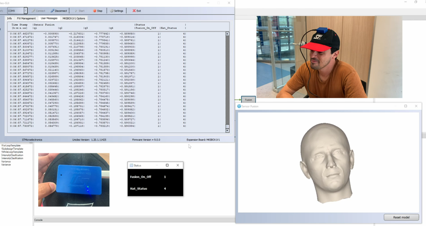

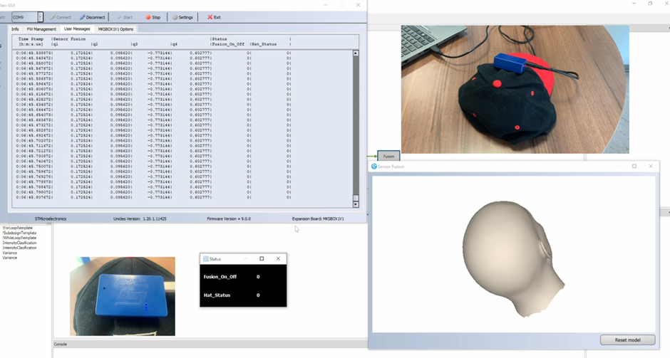

Finally opening Unicleo it is possible to check the output of our algorithm:
  1. If the hat is on the table:
    1.  the hat status is 0, the fusion is not running and its value is zero as well.
    2. The green LED is off and the avatar head is not moving

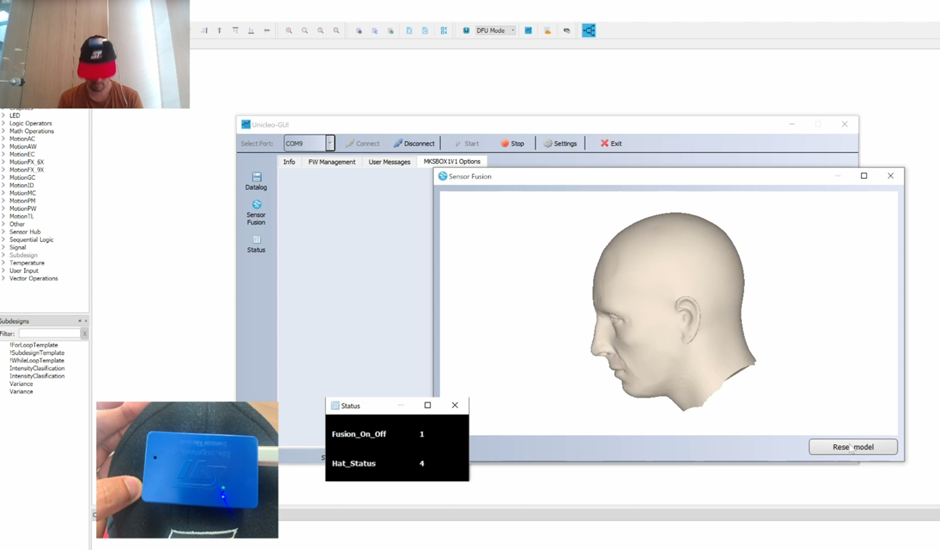

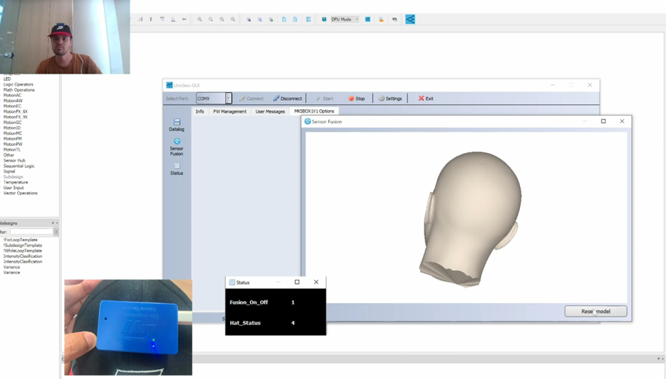

  1. If the hat is on someone’s head, than the hat status is 4, the fusion is 1 and it is computing the sensor fusion and therefore the head is now moving following my head movements.
  2. Finally the green LED is now on
The fusion has a reset model button which is very useful since it allows the self calibration of the model respect to the sensors position.
It is possible for instance to have the face parallel to the screen:
Or the avatar will move with the back of the head visible:
Or the avatar with the face in front of the screen:
