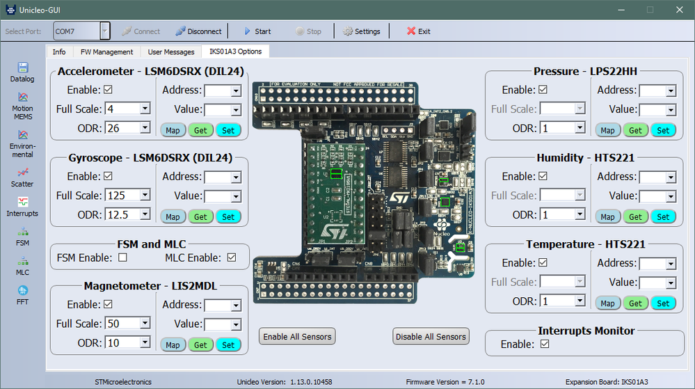

Another possibility for data collection, though less "IoT style", would be to use the X-NUCLEO-IKS01A3 board with Unicleo-GUI, configured as shown in the picture below:

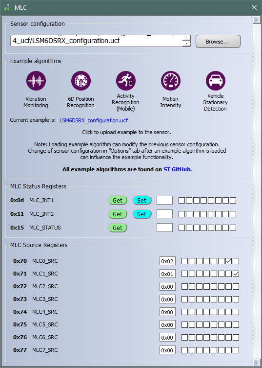

  3. Run Unicleo GUI, connect to the device, click the checkbox to enable the MLC, then click on the MLC button in the left panel, browse and load the .ucf file, finally click the Start button.

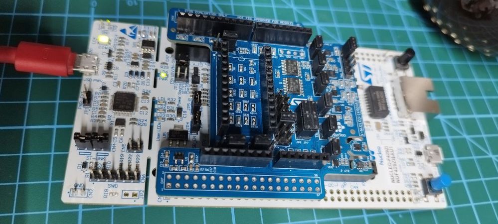

I'm currently working with NUCLEO-F429ZI + IKS01A3 and I can't seem to connect them to see the data in the Unicleo-GUI.
I do everything as in the ST video (the 476 controller is used there) I copy the bin file to the folder of my 429 controller, but the Uncleo-GUI does not see my board. What am I doing wrong ? How can I build IKS01A3 support for my controller and view the data through the Unicleo-GUI.

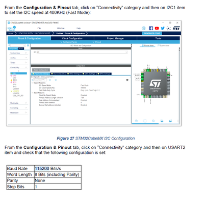

Hello Miroslav, I followed the instructions provided on the document "Getting started with the STMicroelectronics X-CUBE-MEMS1 software package for STM32MX". It is inside the directory \en.x-cube-mems1\Documentation. At page 53 and 60 it is said to set the UART at 115200.
