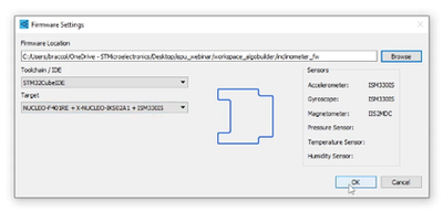

 After saving the updated ispu.json file, open AlgoBuilder tool: click on file, then new design. The firmware settings pop-up window appears:
  • Browse to choose the location where the firmware project is generated by AlgoBuilder: for example, in a new folder called workspace_algobuilder/inclinometer_fw.
  • Choose NUCLEO-F401RE + X-NUCLEO-IKS02A1 + ISM330IS as the target.
Save this design file for AlgoBuilder by naming it inclinometer.xml in the folder called workspace_algobuilder.

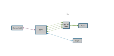

Then add the ISPU block by looking for ISPU inside the filter bar (in the left hand corner of AlgoBuilder). Connect it to the sensor hub inside the main design section of AlgoBuilder. In the properties window, click on Load ISPU UCF file and open the ispu.ucf file of our inclinometer project.
To visualize the fusion block, look for Fusion inside the filter bar. The fusion block takes in input four float values. So, look for mux block inside the filter bar and add it between ISPU and fusion block. The mux block can be configured for four values, by setting: Number of inputs = 4 inside the properties section. Its inputs are the four quaternion values coming from the ISPU block. If you want to visualize the status of the calibration, look for graph inside the filter bar, add the block in the graphical view and configure it with
  • Number of Curves = 1
  • Graph Name = Acc cal
  • Waveform 1 Name = Status
  • Auto-scale ON
inside the properties section. Then connect this block to receive the input from the ISPU block.

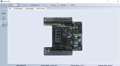

When Unicleo-GUI opens, on the left you can see both the Acc cal and sensor fusion tabs.

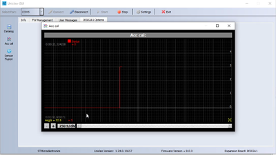

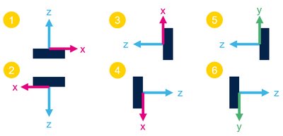

Click on start. If you click on the Acc cal tab, the value now is zero because it is not calibrated. Move the device for a few seconds along all the six faces as described in the picture below to connect all the point needed to complete the accelerometer calibration:
After this calibration, the accuracy of Acc cal is higher.

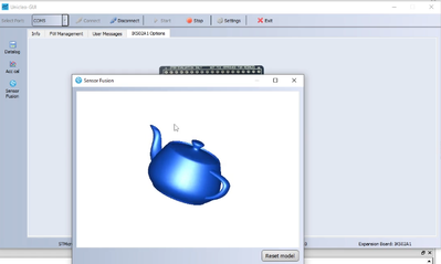

Click on the sensor fusion tab: if you put the device flat on the table, the model (represented here by a teapot) is flat. If the device is tilted along the axes, the teapot is moving accordingly, and everything is extracted with accuracy.
