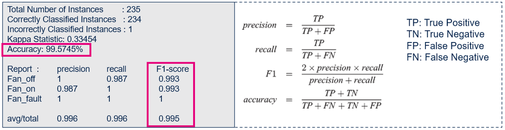

How can we know the decision tree model we have trained is good enough? There are multiple methods available to measure model performance. The most common Key Parameter Index (KPI) to judge the performance of a ML model is the accuracy calculated as percentage of correct predictions vs total number of predictions. Other metrics are available from different combinations of the basic elements, true positives (TP), true negatives (TN), false positives (FP) and false negatives (FN).
With these, it is possible to compute:
  • Precision: the ratio of actual positive observations to the total predicted positive observations
  • Recall (or sensitivity): the ratio of actual positive observations to all the observations in actual class
  • F1-score: the harmonic mean of precision and recall, often used as an alternative of accuracy.

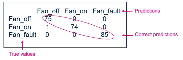

While the discussed KPIs summarize performance results, as an alternative we can also directly visualize the confusion matrix resulting from the testing dataset, as in the example shown below. The numbers in the diagonal represent the right predictions and need to be maximized, while all the numbers in the matrix outside the diagonal are errors in the prediction.
If there is a specific class that tends to be often confused with another one, it may be needed to re-examine again the training dataset used to find possible errors, or to revise the features selection.

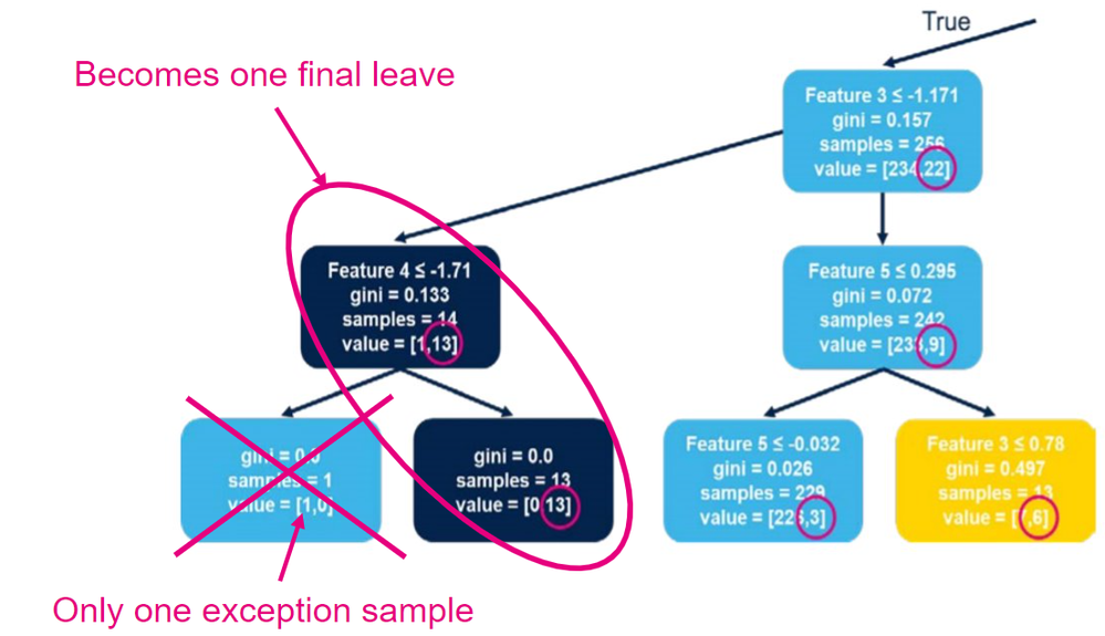

Pruning reduces the leaves which are part of the decision tree that may cause overfitting. Let us take the nodes shown in the figure below as an example.
The left-hand side node (Features 4 ≤ -1.71) of the above decision tree classifies a sole exception sample but the other 13 samples belong to another class. In this case, it could be better to make this node a leaf.

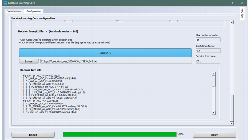

The decision tree algorithm inside Unico-GUI has the option for pruning. We can set up a limited number of nodes and the confidence factor would prune until we meet the condition.

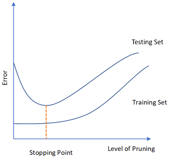

The approach to determine optimum pruning is through monitoring the testing and training accuracy. If we plot the accuracy/error of both testing and training datasets against the level of pruning, we tend to get a plot as shown below.
Without pruning, the model error on training data will be lowest but the error on the testing set can be high due to overfitting. As we increase the level of pruning, the error in the training set will increase, but the error on the validation set will start reducing because some of the nodes were overfit to the noise. As we further increase the pruning, the error on both validation and training sets will increase because pruning will remove nodes that are classifying correctly. This is the point to stop the pruning process.

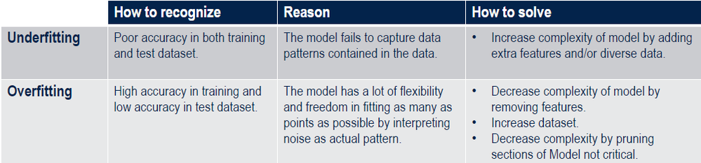

An overview of underfitting and overfitting issues and solutions is summarized below.
