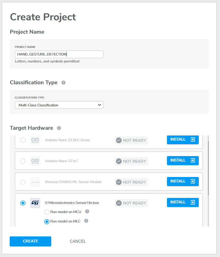

Hand / air gestures detection with SensorTile.box and Qeexo ML: Project Description
For the above-mentioned reasons, the purpose of this article is to build a machine learning model to distinguish between signs written in the air by human hand. The hardware support for this demo is the SensorTile.box, and in particular the machine learning core embedded in the LSM6DSOX sensor.

Before initializing the project, open Qeexo.com and check if you have installed the QeexoML tool on your PC. You might found more practical information in the "Resource" section, in the Installation and in the User guides. When the hardware is ready, you can start the project from the launch page.

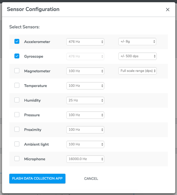

For any sensor configuration, we need to consider three factors:
  • What type of data will capture the differences between our classes
  • What signal length will capture the differences between our classes
  • What range of sensor values will fully capture the range of our input
Based on these factors, we will select accelerometer and gyroscope sensors at 476 Hz for the air gesture problem. We will use +/- 8g and +/- 500 dps for the sensor FSRs.
These two sensors should be able to capture the type of data well, since they are motion sensors and our problem deals with differences in device motion.
Based on hardware memory constraints, we can only use 1024 samples per-channel on the Arduino Nano 33 BLE Sense, so an ODR of 476 Hz should allow us to have a signal length of multiple seconds to make each classification.
Finally, based on the fact that the device will be in motion, we will need a large range of possible sensor values. These larger values of FSR will prevent our sensors from saturation, even under scenarios of rapidly changing device position and speed.
