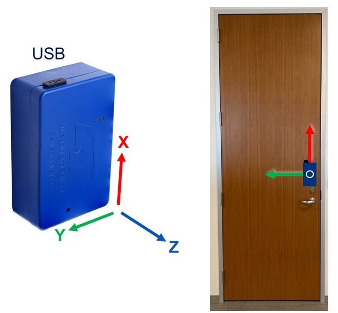

The SensorTile.Box can fit the needs of this application, since its form factor enables a precise positioning on the door, and the data can be stored locally on the onboard SD card.
The tool is placed as shown in the picture below. Other devices can be used as well, provided that the orientation of the sensor axes is correct.
  • X-axis parallel to the door, pointing up.
  • Y-axis parallel to the door, pointing to the door hinges.
  • Z-axis pointing towards the direction of the door opening.

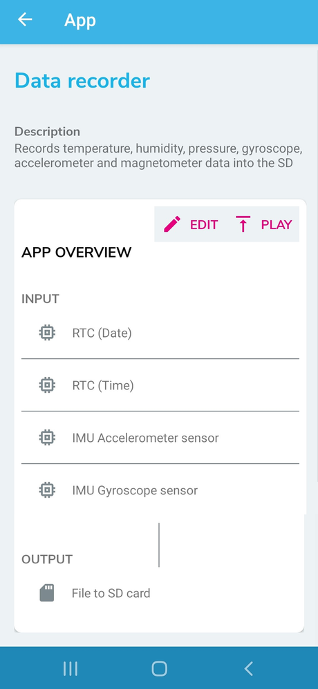

The SensorTile.box has been configured for acquiring various sensors at ODR 52Hz, storing raw data on the onboard SD card. The default "Data recorder" app can be used for this scope. A detailed description of the ST BLE Sensor app configuration can be found

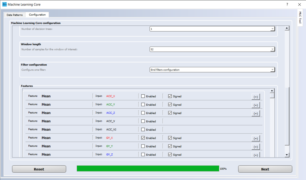

The LSM6DSOX machine learning core (MLC) is configured to run at 52 Hz, computing features on windows of 13 samples, therefore the decision tree classifier output is updated 4 times per second (52 Hz / 13 = 4 Hz).
Only one feature is computed:
  • Mean on gyroscope X-axis
One decision tree with around 4 nodes has been configured to detect the different classes. A meta-classifier has not been used.

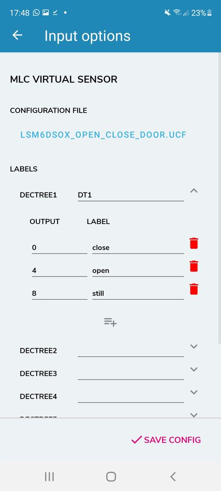

The decision tree classifiers detect 3 different classes corresponding to 3 different door states. The output of the decision tree classifier is stored in the register MLC0_SRC (address 70h).
  • MLC0_SRC (70h) register values
    • 0 = Closing
    • 4 = Opening
    • 8 = Still

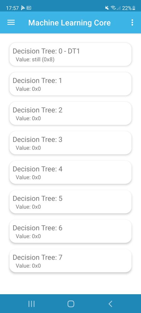

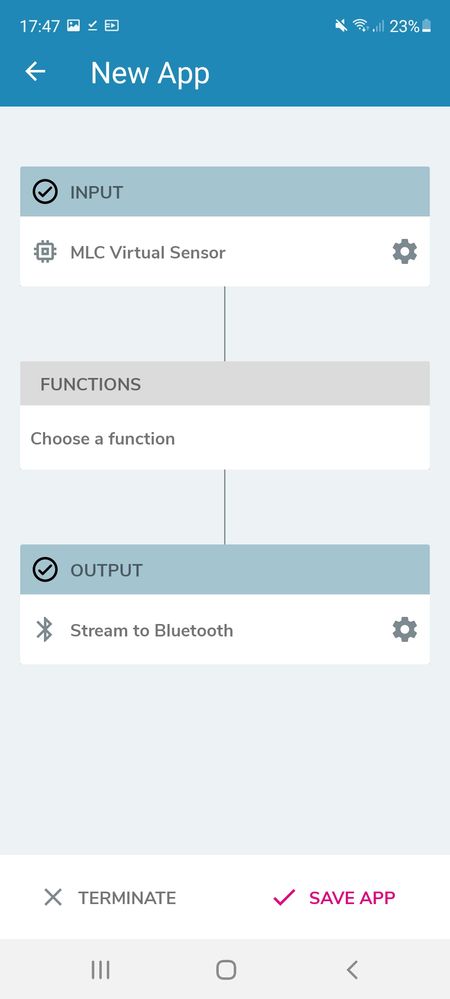

Data visualization with the ST BLE Sensor app
To test the decision tree, STBLE Sensor app visualization method has been preferred. The value of the Decision Tree: 1 varies according to the class label described in the previous paragraphs.
