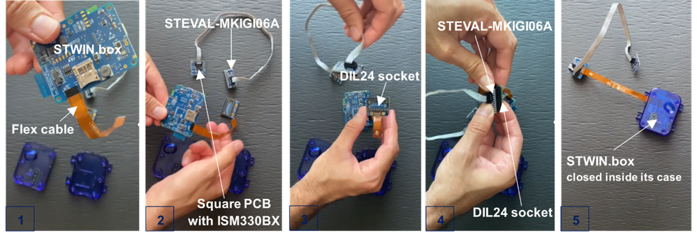

Since the ISM330BX sensor is not available on STWIN.box, we are going to mount it externally using the evaluation kit called STEVAL-MKI245KA.
This kit can be connected to the STWIN.box board through a flex cable and the DIL24 adapter board, as shown in Figure 2.
In particular, the STEVAL-MKI245KA kit is made up of a square PCB, which mounts the ISM330BX 6-axis IMU. It can be connected through flat cable to a generic adapter board (STEVAL-MKIGI06A). The presence of this square PCB ensures proper placement of the ISM330BX in the final application where we want to measure sensor data. The STEVAL-MKIGI06A can be plugged into a standard DIL 24 socket.
Figure 2: Hardware setup: STWIN.box and STEVAL-MKI245KAFigure 2: Hardware setup: STWIN.box and STEVAL-MKI245KA

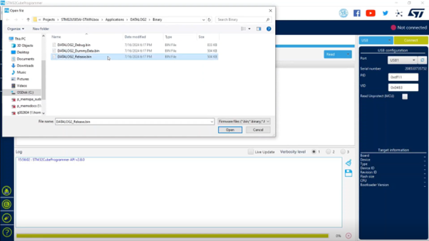

Then we can use the tool STM32CubeProgrammer for loading the binary. In STM32CubeProgrammer, we can select the DATALOG2_Release.bin firmware in the binary folder and upload it to the device.
Figure 4: Loading of STWIN.box firmwareFigure 4: Loading of STWIN.box firmware

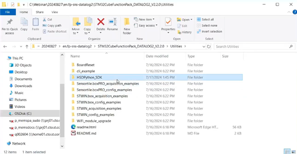

We are going to use the Python tools available in the function pack. Therefore, we are installing the high speed datalog Python SDK, in a virtual environment of Python version 3.10.
The user can find the details of the installation in the readme files available in the package.
Figure 5: HSDPython_SDK installationFigure 5: HSDPython_SDK installation

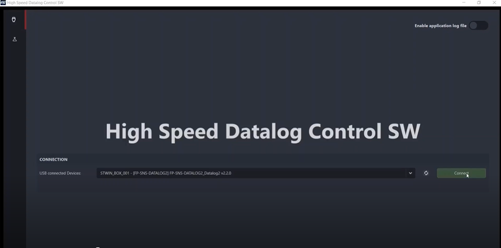

When the Python SDK has been installed, we can launch the high speed datalog graphical user interface.
In the GUI, the connect button allows the connection between the board and the PC.
Figure 6: High Speed Datalog GUI – Connect buttonFigure 6: High Speed Datalog GUI – Connect button

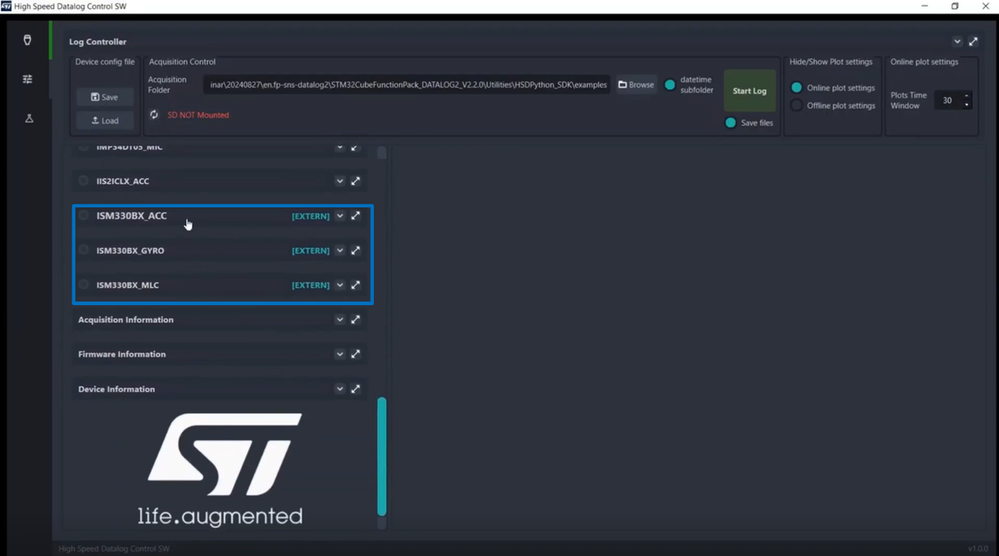

Once the connection is established, we can enable or disable the needed sensor.
In this case, we are enabling our ISM330BX.
Figure 7: High Speed Datalog GUI – Enabling ISM330BXFigure 7: High Speed Datalog GUI – Enabling ISM330BX

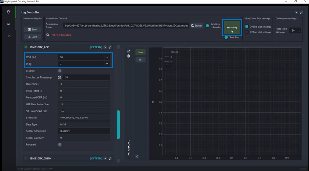

We can set up the data rate and full scale of the sensor. We can load the safe configuration and start and stop data logging on our PC.
Figure 8: High Speed Datalog GUI – Setting ODR and FS and Start/Stop loggingFigure 8: High Speed Datalog GUI – Setting ODR and FS and Start/Stop logging

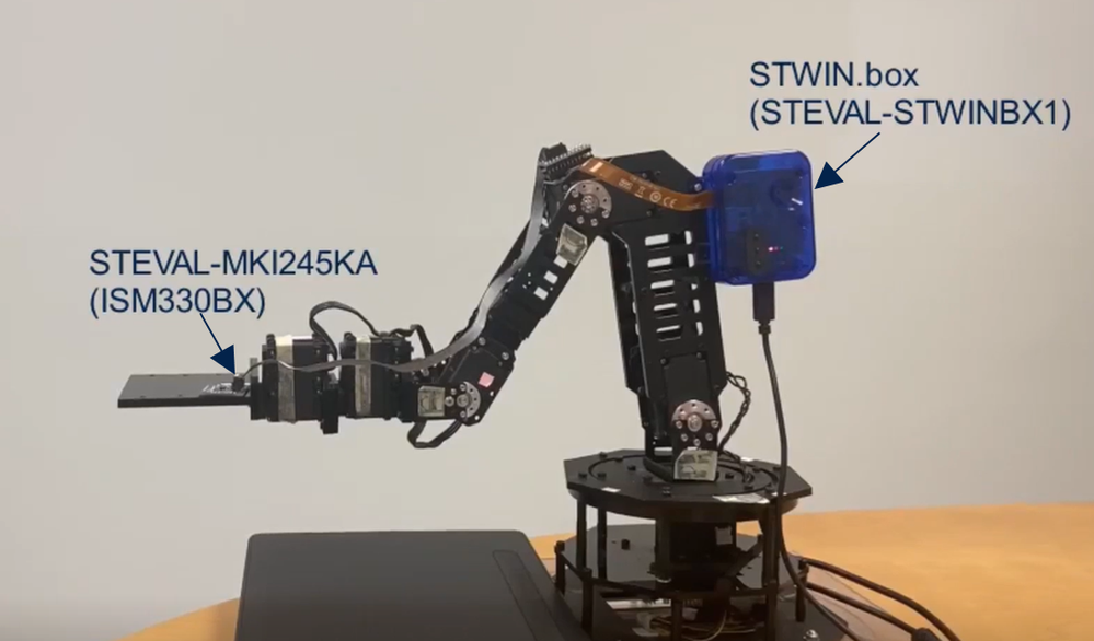

We have mounted the STWIN.box board and ISM330BX sensor on a robotic arm to show that it is possible to distinguish different conditions. Stationary, a pick and place movement, or any kind of anomaly that could happen when the cobot performs an unexpected movement. In this way, it can be automatically blocked.
Figure 9: STWIN.box and ISM330BX mounted on a robotic arm for anomaly detectionFigure 9: STWIN.box and ISM330BX mounted on a robotic arm for anomaly detection

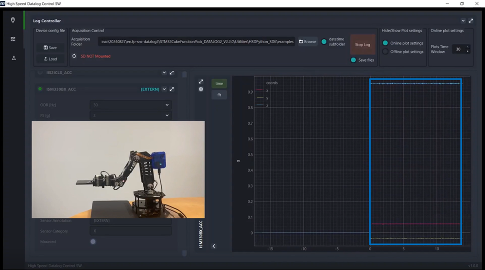

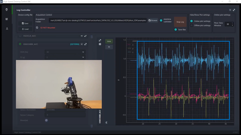

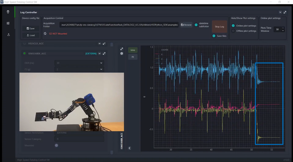

We are going to acquire limited data just for a quick demonstration. The first class is stationary (see figure 11), then the pick and place movement (see figure 12), which is repeated multiple times. This movement is performed by the robotic arm to pick some object from one location and place it to another location.
Finally, the anomaly (see Figure 13) which stops the cobot.
Figure 11: Robotic arm – Detection of stationary stateFigure 11: Robotic arm – Detection of stationary state
Figure 12: Robotic arm – Detection of pick and place movementFigure 12: Robotic arm – Detection of pick and place movement
Figure 13: Robotic arm – when the anomaly is detected, the robotic arm stops movingFigure 13: Robotic arm – when the anomaly is detected, the robotic arm stops moving
