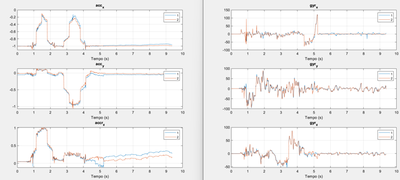

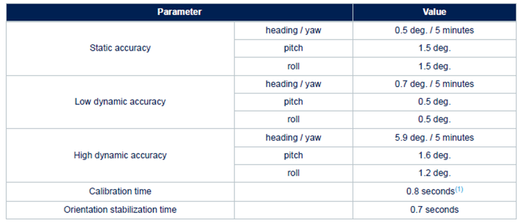

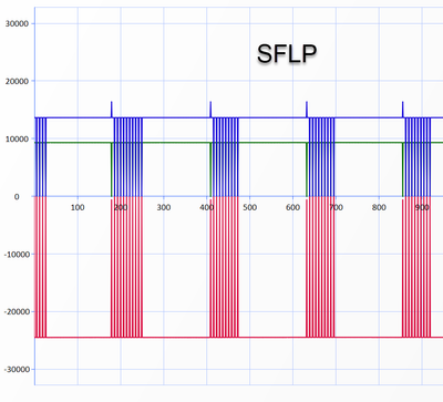

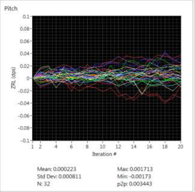

Sensor fusion performance and time required to reach steady state

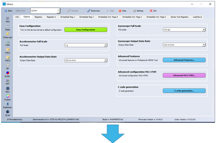

3. SFLP demo and tools

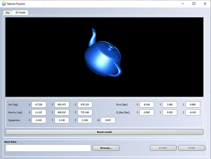

The hardware setup is STEVAL-MKI109V3 and DIL24 adapter board STEVAL-MKI227KA.
STEVAL-MKI109V3STEVAL-MKI109V3DIL24 adapterDIL24 adapter
The software used is Unico-GUI.
When you shake the demo board, the image follows the actual position displayed. SFLP has integrated quaternion, so customers can directly get quaternion and convert it into euler angles.

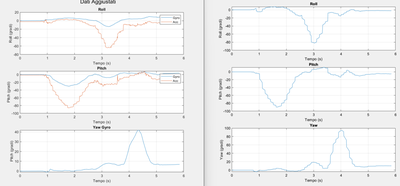

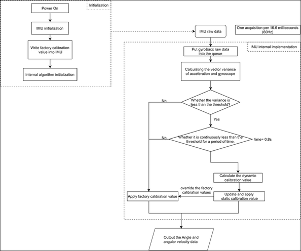

4. Yaw angle automatic calibration flow
Due to the long-term operation of the gyroscope, the integration error caused by zero deviation becomes increasingly large. The yaw angle may experience significant drift due to lack of calibration of the magnetometer. To solve this problem, the SFLP algorithm adopts a dynamic self-calibration method to ensure yaw angle stability.
5. Automatic calibration flow

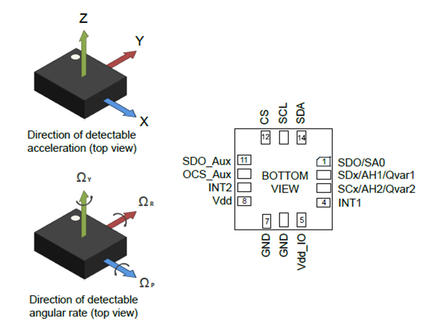

Coordinates:
Pitch rotation around the X-axisΩP
Roll rotation around the Y-axis ΩR
Heading/Yaw rotation around the Z-axisΩY

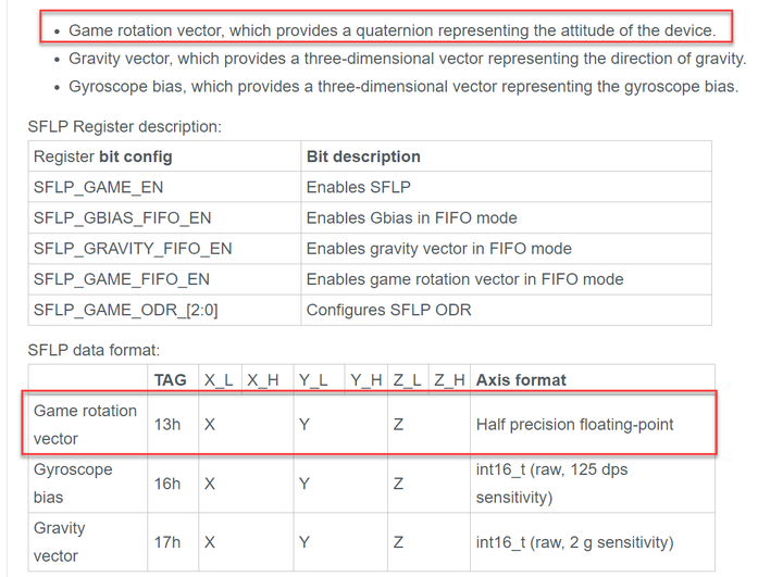

  • Game rotation vector, which provides a quaternion representing the attitude of the device.
  • Gravity vector, which provides a three-dimensional vector representing the direction of gravity.
  • Gyroscope bias, which provides a three-dimensional vector representing the gyroscope bias.
SFLP Register description:
Register bit config
Bit description
SFLP_GAME_EN
Enables SFLP
SFLP_GBIAS_FIFO_EN
Enables Gbias in FIFO mode
SFLP_GRAVITY_FIFO_EN
Enables gravity vector in FIFO mode
SFLP_GAME_FIFO_EN
Enables game rotation vector in FIFO mode
SFLP_GAME_ODR_[2:0]
Configures SFLP ODR

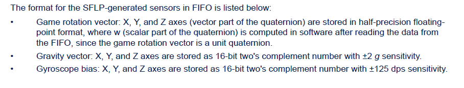

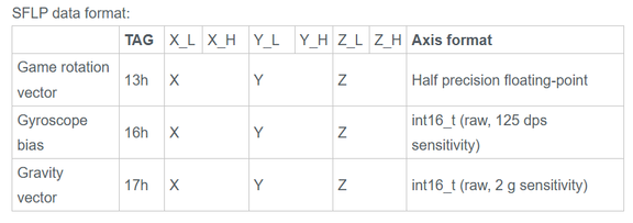

SFLP data format:
TAG
X_L
X_H
Y_L
Y_H
Z_L
Z_H
Axis format
13h
X
Y
Z

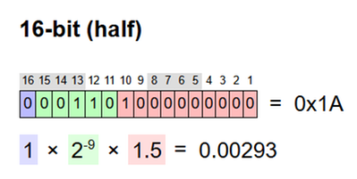

Half precision floating-point
Gyroscope bias
16h
X
Y
Z
int16_t (raw, 125 dps sensitivity)
Gravity vector
17h
X
Y
Z
int16_t (raw, 2 g sensitivity)

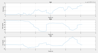

I am using a STM32F401RE board with the X-NUCLEO-IKS4A1 expansion board. I wrote the following code to get the quaternion values ​​and display them in MEMS Studio or Unicleo-GUI but after uploading the project to the board I cannot see the quaternion data on MEMS Studio or Unicleo-GUI. Am I doing something wrong?

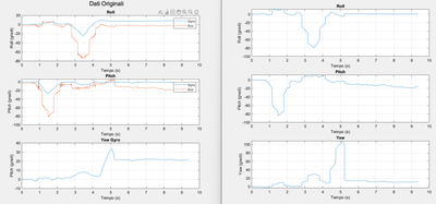

I did a quick check of your code: it is printing the output values to serial terminal so you should use a serial terminal to see the quaternions.
marti3110
Associate III
@Denise SANFILIPPO I managed to visualize the quaternions through the output terminal and saved the data.
The commans I used are:
fifo_sflp.game_rotation = 1;
fifo_sflp.gravity = 1;
fifo_sflp.gbias = 1;
lsm6dsv16x_fifo_sflp_batch_set(&dev_ctx, fifo_sflp);
lsm6dsv16x_fifo_mode_set(&dev_ctx, LSM6DSV16X_STREAM_MODE);
lsm6dsv16x_xl_data_rate_set(&dev_ctx, LSM6DSV16X_ODR_AT_30Hz); // ODR dell'accelerometro
lsm6dsv16x_gy_data_rate_set(&dev_ctx, LSM6DSV16X_ODR_AT_30Hz); // ODR del giroscopio
lsm6dsv16x_sflp_data_rate_set(&dev_ctx, LSM6DSV16X_SFLP_30Hz);
lsm6dsv16x_sflp_game_rotation_set(&dev_ctx, PROPERTY_ENABLE);
lsm6dsv16x_sflp_gbias_t gbias;
gbias.gbias_x = 0.0f;
gbias.gbias_y = 0.0f;
gbias.gbias_z = 0.0f;
lsm6dsv16x_sflp_game_gbias_set(&dev_ctx, &gbias);
while (1)
// Controlla lo stato del FIFO
lsm6dsv16x_fifo_status_get(&dev_ctx, &fifo_status);
if (fifo_status.fifo_th == 1) {
// Leggi i dati dal FIFO
uint16_t num_samples = fifo_status.fifo_level;
while (num_samples--) {
lsm6dsv16x_fifo_out_raw_t raw_data;
lsm6dsv16x_fifo_out_raw_get(&dev_ctx, &raw_data);
int16_t *axis;
float gravity_mg[3];
float gbias_mdps[3];
// Se i dati sono del Game Rotation Vector
if (raw_data.tag == LSM6DSV16X_SFLP_GAME_ROTATION_VECTOR_TAG) {
// Converti i dati grezzi in quaternioni
sflp2q(quaternion, (uint16_t*)&raw_data.data[0]);
// Invia i dati via UART
snprintf((char*)tx_buffer, sizeof(tx_buffer), "Game Rotation \tX: %2.3f\tY: %2.3f\tZ: %2.3f\tW: %2.3f\r\n", quaternion[0], quaternion[1], quaternion[2], quaternion[3]);
tx_com(tx_buffer, strlen((char const*)tx_buffer));
else if (raw_data.tag == LSM6DSV16X_SFLP_GYROSCOPE_BIAS_TAG)
axis = (int16_t *)&raw_data.data[0];
gbias_mdps[0] = lsm6dsv16x_from_fs125_to_mdps(axis[0]);
gbias_mdps[1] = lsm6dsv16x_from_fs125_to_mdps(axis[1]);
gbias_mdps[2] = lsm6dsv16x_from_fs125_to_mdps(axis[2]);
snprintf((char *)tx_buffer, sizeof(tx_buffer), "GBIAS [mdps]:%4.2f\t%4.2f\t%4.2f\r\n",
(double_t)gbias_mdps[0], (double_t)gbias_mdps[1], (double_t)gbias_mdps[2]);
tx_com(tx_buffer, strlen((char const *)tx_buffer));
else if (raw_data.tag == LSM6DSV16X_SFLP_GRAVITY_VECTOR_TAG)
gravity_mg[0] = lsm6dsv16x_from_sflp_to_mg(axis[0]);
gravity_mg[1] = lsm6dsv16x_from_sflp_to_mg(axis[1]);
gravity_mg[2] = lsm6dsv16x_from_sflp_to_mg(axis[2]);
snprintf((char *)tx_buffer, sizeof(tx_buffer), "Gravity [mg]:%4.2f\t%4.2f\t%4.2f\r\n",
(double_t)gravity_mg[0], (double_t)gravity_mg[1], (double_t)gravity_mg[2]);
MX_MEMS_Process();

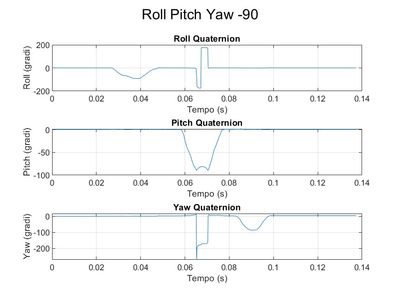

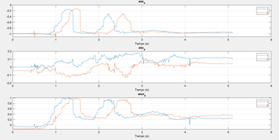

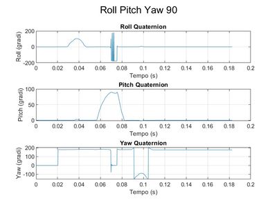

The commands I used to get Euler angles from quaternions in Matlab are the following:
"q=quaternion(W_values,X_values,Y_values,Z_values);
angles=eulerd(q,'ZYX','frame');
roll_eulerd=angles(:,3);
pitch_eulerd=angles(:,2);
yaw_eulerd=angles(:,1);
yaw_eulerd = yaw_eulerd - yaw_eulerd(1);"
In the first acquisition I performed a roll:+90, pitch:+90, yaw:+90 rotation and in the second acquisition I performed a roll:-90, pitch:-90, yaw:-90 rotation and I get the attached graphs.  roll_pitch_yaw_90.jpeg
 The pitch angle corresponds to the rotations made but the Roll angle varies even when it varies pitch angle and the Yaw angle instead always has a strange trend.
I also encountered this problem when implementing the Motion FX 6x and Motion FX 9x libraries and getting quaternions as output.
Since for my project I need to obtain very precise angles that do not vary when there is rotation around a single axis, what can I do?

Hi @marti3110 ,
This is not a problem with the algorithm (neither SFLP nor MotionFX 6X / 9X), but with the representation of the output using Euler angles, which by nature suffer from the well-known ‘gimbal lock’ issue.
If you try SFLP with MEMS Studio which visualizes the outputs via a 3D model (rotated using the quaternion generated by the sensor), you will see that the algorithm works more than well and without jumps.

Denise SANFILIPPO
Hi @Stefan3 ,
Here is a short explanation about the FIFO and SFLP block inside LSM6DSV16X:
The FIFO can be configured to store the SFLP game rotation vector, gravity vector, gyroscope bias.
The reconstruction of a FIFO stream is a simple task thanks to the TAG_SENSOR_[4:0] field of the FIFO_DATA_OUT_TAG register that allows recognizing the meaning of a word in FIFO.
For SFLP, the table below contains the values for the TAG_SENSOR_[4:0] field:
TAG_SENSOR_[4:0] Sensor name Sensor name Description
0x13 Game rotation vector Virtual SFLP-generated game rotation vector
0x16 Gyroscope bias Virtual SFLP-generated gyroscope bias
0x17 Gravity vector Virtual SFLP-generated gravity vector
Data can be retrieved from the FIFO through six dedicated registers, from address 79h to 7Eh, in particular:
• FIFO_DATA_OUT_X[15:0] = FIFO_DATA_OUT_X_L + FIFO_DATA_OUT_X_H << 8
• FIFO_DATA_OUT_Y[15:0] = FIFO_DATA_OUT_Y_L + FIFO_DATA_OUT_Y_H << 8
• FIFO_DATA_OUT_Z[15:0] = FIFO_DATA_OUT_Z_L + FIFO_DATA_OUT_Z_H << 8
A dedicated sensor fusion block (SFLP) is available for generating the following virtual sensors based on
processing the accelerometer and gyroscope data:
• Gravity vector, which provides a three dimensional vector representing the direction of gravity
• Gyroscope bias, which provides a three dimensional vector representing the gyroscope bias
SFLP-generated sensors are read only from FIFO and they are selectively enabled:
• Game rotation vector is batched by setting the SFLP_GAME_FIFO_EN bit of the EMB_FUNC_FIFO_EN_A
register to 1.
• Gravity vector is batched by setting the SFLP_GRAVITY_FIFO_EN bit of EMB_FUNC_FIFO_EN_A
register to 1.
• Gyroscope bias is batched by setting the SFLP_GBIAS_FIFO_EN bit of the EMB_FUNC_FIFO_EN_A
register to 1.
If batching in FIFO is enabled, the SFLP-generated sensors are stored in FIFO according to the SFLP output data rate.
The format for the SFLP-generated sensors in FIFO is listed below:
• Game rotation vector: X, Y, and Z axes (vector part of the quaternion) are stored in half-precision floating point format, where w (scalar part of the quaternion) is computed in software after reading the data from
the FIFO, since the game rotation vector is a unit quaternion.
• Gravity vector: X, Y, and Z axes are stored as 16-bit two's complement number with ±2 g sensitivity.
• Gyroscope bias: X, Y, and Z axes are stored as 16-bit two's complement number with ±125 dps sensitivity.
I suggest looking at the following example lsm6dsv16x_sensor_fusion available inside our official GitHub: it can be useful to understand the various steps needed to use SFLP with LSM6DSV16X.
Please refer also to AN5763 for further info.

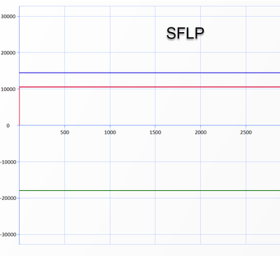

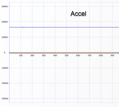

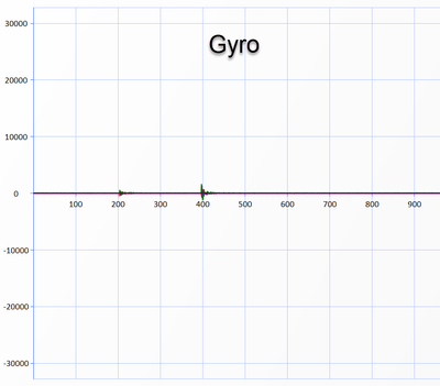

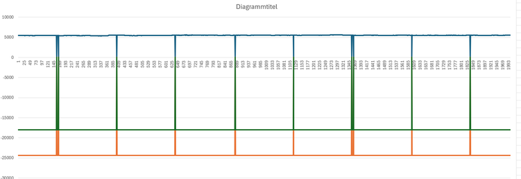

Stefan3
Associate II
Hi Denis
I have a very nice signal from the Accellero and from Gyroscope.
From the SFLP I get some problems.
Denise SANFILIPPO
Hi @Stefan3 ,
can you provide more details about your plots?
In particular, how are you reading SFLP data and which is the unit of measurement of your plots?
Stefan3
Associate II
Hi Denis
I read with an Interrupt 30Hz the six register and display the read value 1000 times in Chart. I do not move the sensor. For the first test I read only Gyro data, for the second only Acceloero data and for the third test only the fusion data.
If I move the sensor all values change, that would be ok so far
Denise SANFILIPPO
Hi @Stefan3 ,
Are you converting the SFLP output data from half-precision floating-point format (float16) to float format?
You should interpret SFLP data as follows:
Please note that the SFLP output data is quaternions, not angles.
Stefan3
Associate II
Hi Denis
I guess I still have to read FIFO_DATA_OUT_TAG (78h) and wait until the value there is 0x13, 0x16 or 0x17.
Or how do I know which data to read?
Denise SANFILIPPO
Hi @Stefan3,
yes, by reading the FIFO_DATA_OUT_TAG register, it is possible to understand to which sensor the data of the current reading belongs and to check if data are consistent. In fact, the reconstruction of a FIFO stream is a simple task thanks to the TAG_SENSOR field of the FIFO_DATA_OUT_TAG register that allows recognizing the meaning of a word in FIFO.
Stefan3
Associate II
Hi Denis

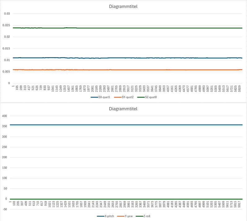

With the attention of the TAG I can now read SFLP.
But in the data I regularly had wrong values.
For example 20,21,24. in all the 3Channel
Every time I got these values, I read the data again and then they were ok again.
Now I am trying to convert the values into roll, pitch, yaw
Stefan3
Associate II
Hi Denis
I have to read the game vectors and send them from the board to the computer.
In the computer I can convert the half precision floating to Float32.
The values I get are from about -0.9 to +0.9.
Now I have to convert these values into yaw, roll, pitch.
These values should be 0-360 degrees (or +-180 degrees).
How do I do this? I can't just multiply by 180

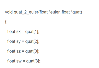

Denise SANFILIPPO
Hi @Stefan3,
Here below you can find an example based on quaternions read by the IMU. The IMU is oriented according to ENU frame.
The formula below can be used to convert the quaternions to Euler angles.
void quat_2_euler(float *euler, float *quat)
  float sx = quat[1];
  float sy = quat[2];
  float sz = quat[0];
  float sw = quat[3];
  if (sw < 0.0f) {
    sx *= -1.0f;
    sy *= -1.0f;
    sz *= -1.0f;
    sw *= -1.0f;
  float sqx = sx * sx;
  float sqy = sy * sy;
  float sqz = sz * sz;
  euler[0] = -atan2f(2.0f * (sy * sw + sx * sz), 1.0f - 2.0f * (sqy + sqx));
  euler[1] = -atan2f(2.0f * (sx * sy + sz * sw), 1.0f - 2.0f * (sqx + sqz));
  euler[2] = -asinf(2.0f * (sx * sw - sy * sz));

Hi Denis, Hi Eliane
I read the game rotation vectors from the LSM9
But unfortunately no fourth value. This is called the scalar part. float sw = quat[3];
How do I calculate this scalar part or how do I read it?
  float sx = quat[1];
  float sy = quat[2];
  float sz = quat[0];
 float sw = quat[3];
Denise SANFILIPPO
Hi @Stefan3 ,
as AN5763 states, X, Y, and Z axes (vector part of the quaternion) of the game rotation vector are stored in half-precision floating-point format, while w (scalar part of the quaternion) is computed in software after reading the data from the FIFO, since the game rotation vector is a unit quaternion.
You can refer to our GitHub to retrieve the scalar part w of the quaternion, starting from X, Y, Z of the game rotation vector. Focus on the sflp2q function:
 static void sflp2q(float quat[4], uint16_t sflp[3])
     float sumsq = 0;
     quat[0] = npy_half_to_float(sflp[0]);
     quat[1] = npy_half_to_float(sflp[1]);
     quat[2] = npy_half_to_float(sflp[2]);
     for (uint8_t i = 0; i < 3; i++)
     sumsq += quat[i] * quat[i];
     if (sumsq > 1.0f) {
     float n = sqrtf(sumsq);
     quat[0] /= n;
     quat[1] /= n;
     quat[2] /= n;
     sumsq = 1.0f;
     quat[3] = sqrtf(1.0f - sumsq);
Stefan3
Associate II
Hi Denis
It now works from configuring the LSM6, reading from FIFO, sending to USB and receiving in the App.
Also the conversion from FP16 to FB32 and the calculation of pitch, yaw, roll and each in grad degres is perfect.
A small problem is still, regular spikes in the data.
In decimal the values are about 20-40 und if I convert to FP32 it's looks like a very small number or somtimes very high number
I suppose I read a counter or something similar instead of the quaternion.
Denise SANFILIPPO
Hi @Stefan3 ,
In general, you must read from the FIFO (e.g., a set of 7 bytes) and interpret the contents of the data section according to the tag, as you did.
Is the plotted data the data which has been converted to float?
Or do you multiply the data by a scaling factor? Data should be in the range [-1;1].
Stefan3
Associate II
Hi Denis
Ok before I had only read 1 byte and if that was correct then I have read the 6 others.
With your suggestion to read 7 at once and then when the tag is right I use it, it works very well and also faster.
I can read and transmit at 15Hz, 30Hz, 60Hz, 120Hz, 240Hz, 480Hz without any problems.
The old chart shows Pitch, Yaw, Roll in Grad degrees.
Here a new chart with both, the convertet Float32 value (top) and the chart with the Pitch, Yaw, Roll (bottom). The x (pitch) is 358 grad. It changes the value when I turn, but I suspect not in the right range
Denise SANFILIPPO
Hi @Stefan3
a possible error in your code could be an incorrect convention used inside the function called “quat_2_euler”.
My suggestion is to convert the quaternion in such a way it is in the format [x, y, z, w], then you should pass it to the function void quat_2_euler(float *euler, float *quat) without applying any swap of the axes.
So the input of the quat_2_euler function must be quaternion (quat) in the format [x, y, z, w], while the output are the Euler angles in the format [yaw, pitch, roll] in deg. The convention of the Euler angles are that for Android.
Stefan3
Associate II
Hi Denis
In your code, the axes are assigned as follows in the picture.
I have now done the same for me.
And I use this:
yaw=euler[0]
pitch=euler[1]
roll=euler[2]
Then the results look different. I will do further tests and see how it goes.

marti3110
Associate III
Hi @Denise SANFILIPPO , I am making a project where I use two LSM6DSV16X sensors (in particular two SparkFun Micro 6DoF IMU Breakout LSM6DSV16X (Qwiic), one with address 0x6A and one with address 0x6B) and the Nucleo F401RE board.
I am connecting the two sensors to the same I2C bus because I want simultaneous acquisition. My goal is to get the accelerometer, gyroscope and quaternions data from each of the two sensors.
I tested the two sensors individually by writing a dedicated code (I only change the address):
	float sumsq = 0;
	if (sumsq > 1.0f) {
		quat[0] /= n;
		quat[1] /= n;
		quat[2] /= n;
		sumsq = 1.0f;

Based on this code I wrote another code to allow simultaneous acquisition from the two sensors:
					sflp2q(quaternion1, (uint16_t*)&raw_data.data[0]);
					snprintf((char*)tx_buffer1, sizeof(tx_buffer1), "Game Rotation 1 \tX: %2.3f\tY: %2.3f\tZ: %2.3f\tW: %2.3f\r\n",
							quaternion1[0], quaternion1[1], quaternion1[2], quaternion1[3]);

The problem is that the acquisition is not simultaneous, the data is very skewed and the quaternions are completely wrong. Am I doing something wrong in my code? Do you have any suggestions on how to improve the acquisition?
Denise SANFILIPPO
Hi @marti3110 ,
what do you mean with "the data is very skewed and the quaternions are completely wrong"?
Can you explain it better?
marti3110
Associate III

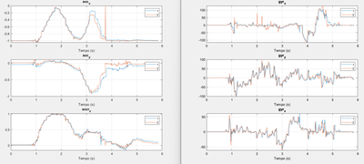

I tried the Continuous Mode and the FIFO Mode. In both cases I acquire data from two sensors performing the same movement simultaneously.
With the "Continuous Mode", for each occurrence (i.e. ACC1, ACC2, GYR1, GYR2, etc) the number of values ​​I get is different. Also, Sensor 2 data is lagging behind sensor 1 data. There is a delay in acquiring data from sensor 1 and sensor 2:
The figure shows the accelerometer data. Curve 1 indicates the data from sensor 1 and curve 2 indicates the data from sensor 2. Having performed the same movement at the same time, it is clear that there is a problem when the data is printed on the terminal.The figure shows the accelerometer data. Curve 1 indicates the data from sensor 1 and curve 2 indicates the data from sensor 2. Having performed the same movement at the same time, it is clear that there is a problem when the data is printed on the terminal.
 Also, from the quaternion I obtain the following angles whose trend is very strange and does not appear continuous:
I think the main problem is in the data management in FIFO. I don't understand why the data is not printed in order, i.e. "Game Rotation 1, Game Rotation 2, GYR1,GYR2, ACC1,ACC2" but the order changes over time (see this post Issue with Misaligned Accelerometer and Gyroscope ... - STMicroelectronics Community)
For the "FIFO Mode" the code is:

	fifo_sflp1.game_rotation = 1;
	fifo_sflp1.gravity = 1;
	fifo_sflp1.gbias = 1;
	lsm6dsv16x_fifo_sflp_batch_set(&dev_ctx1, fifo_sflp1);
	// Imposta batch FIFO di dati sflp sensore 2
	fifo_sflp2.game_rotation = 1;
	fifo_sflp2.gravity = 1;
	fifo_sflp2.gbias = 1;
	lsm6dsv16x_fifo_sflp_batch_set(&dev_ctx2, fifo_sflp2);

		if (raw_data1.tag == LSM6DSV16X_SFLP_GAME_ROTATION_VECTOR_TAG) {
			sflp2q(quaternion1, (uint16_t*)&raw_data1.data[0]);
					"Game Rotation 1: X: %2.3f Y: %2.3f Z: %2.3f W: %2.3f\n",
					quaternion1[0], quaternion1[1], quaternion1[2], quaternion1[3] );
	float sumsq = 0;
	if (sumsq > 1.0f) {
		quat[0] /= n;
		quat[1] /= n;
		quat[2] /= n;
		sumsq = 1.0f;
/* USER CODE END 4 */

I have acquired both FIFO_WATERMARK set to 64 and 200, but the results I get are not satisfactory. Unlike "Continuous Mode", with "FIFO Mode" there is less lag between the data from the two sensors:
Watermark=200Watermark=200
Watermark=64Watermark=64
Furthermore, trying to obtain the angles from the acquired data I get the following graphs:
In the image on the left the angles are obtained by integrating the gyroscope data "gyro_angle_x = zeros(length(gyr_x),1); gyro_angle_y = zeros(length(gyr_y),1); gyro_angle_z = zeros(length(gyr_z),1);  for i = 2:length(gyr_x) dt = time_s(i) - time_s(i-1); % Time interval gyro_angle_x(i) = gyro_angle_x(i-1) + gyr_x(i) * dt; % X-axis angle gyro_angle_y(i) = gyro_angle_y(i-1) + gyr_y(i) * dt; % Y-axis angle gyro_angle_z(i) = gyro_angle_z(i-1) + gyr_z(i) * dt; % Z-axis angle end " , for the accelerometer instead "acc_roll = zeros(length(acc_x),1); acc_pitch = zeros(length(acc_y),1);  for i = 2:length(gyr_x) acc_roll(i) = atan2(acc_y(i), sqrt(acc_x(i)^2 + acc_z(i)^2)); acc_pitch(i)= atan2(-acc_x(i), sqrt(acc_y(i)^2 + acc_z(i)^2)); end " but the measurements differ too much (while if I acquire the data from a single sensor the results almost match). In the image on the right the angles obtained starting from the quaternions are represented and here too the trend does not appear continuous buIn the image on the left the angles are obtained by integrating the gyroscope data "gyro_angle_x = zeros(length(gyr_x),1); gyro_angle_y = zeros(length(gyr_y),1); gyro_angle_z = zeros(length(gyr_z),1); for i = 2:length(gyr_x) dt = time_s(i) - time_s(i-1); % Time interval gyro_angle_x(i) = gyro_angle_x(i-1) + gyr_x(i) * dt; % X-axis angle gyro_angle_y(i) = gyro_angle_y(i-1) + gyr_y(i) * dt; % Y-axis angle gyro_angle_z(i) = gyro_angle_z(i-1) + gyr_z(i) * dt; % Z-axis angle end " , for the accelerometer instead "acc_roll = zeros(length(acc_x),1); acc_pitch = zeros(length(acc_y),1); for i = 2:length(gyr_x) acc_roll(i) = atan2(acc_y(i), sqrt(acc_x(i)^2 + acc_z(i)^2)); acc_pitch(i)= atan2(-acc_x(i), sqrt(acc_y(i)^2 + acc_z(i)^2)); end " but the measurements differ too much (while if I acquire the data from a single sensor the results almost match). In the image on the right the angles obtained starting from the quaternions are represented and here too the trend does not appear continuous bu
So I don't know which of the two modes to use because both still have problems and I don't know how to get the best data.
marti3110
Associate III
What can I do to improve this situation?
Denise SANFILIPPO
Hi @marti3110,
here are some tips/comments which can help you:
- Using FIFO in FIFO mode or continuous mode does not change anything if the data is read and the FIFO does not fill up.
- Surely you could use I2C at 400 kHz instead of 100 kHz, in fact as it is now, it is super slow to do any kind of operation.
- If you want to compare the output of the fusion, why do you need the raw data? I think it depends on your specific use case, can you tell me something more?
- There are techniques to improve synchronization, however, only on raw data, not on SFLP.

The quaternion is simply one more piece of data to be read from the FIFO and transmitted. If you have read/transmit problems, perhaps you should try using I2C @ 400 kHz and possibly pack all the data you want to transmit with UART and transmit it in a single transaction using DMA.
