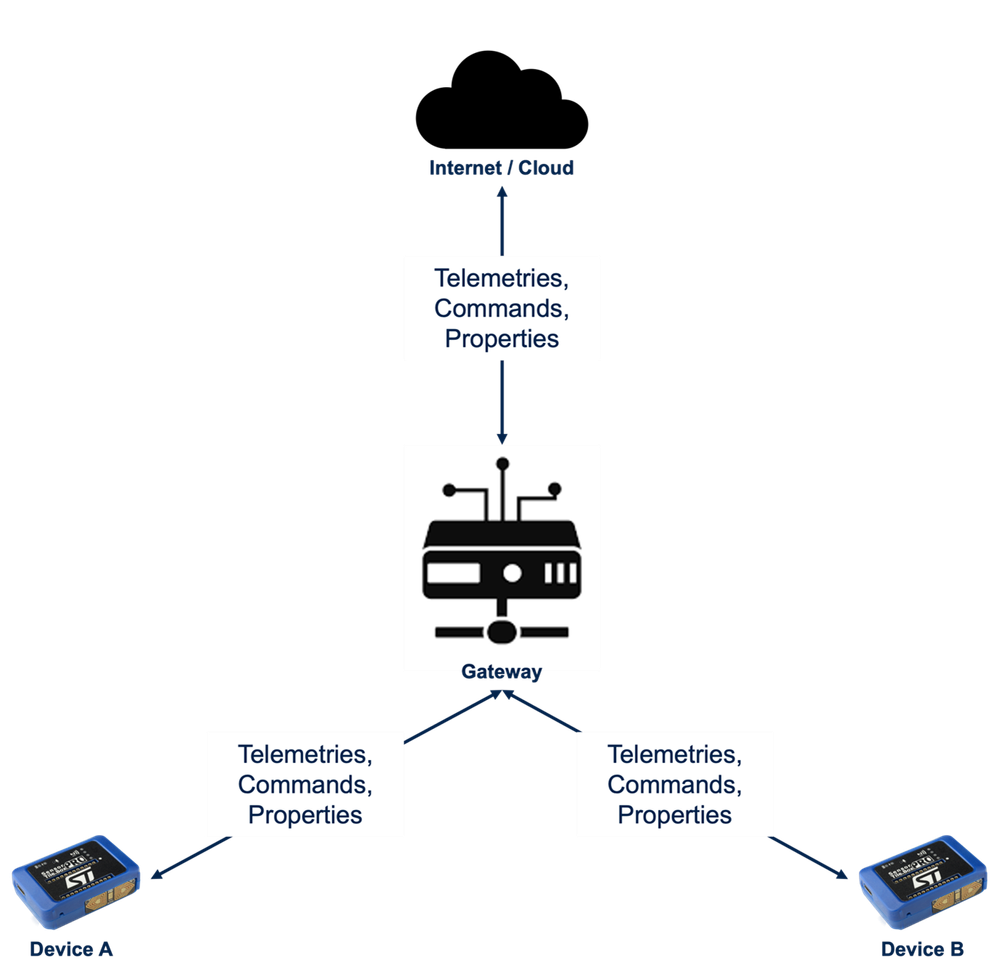

1. Definition of the entities that comprise an IoT system
A device is any physical entity, which is closer to the data source being measured. Devices are equipped with sensors and actuators, have limited processing capability, and are not connected to any internet connection by themselves. In the context of ST AIoT Craft, examples of supported devices are the SensorTile.box PRO and STWIN.box boards. Internet connectivity, along with other advanced functionalities, is provided instead by a gateway.
A gateway is a component that acts as an intermediary between the connected devices and the cloud/internet. It provides a bridge that allows data to flow effectively and securely between the local environment and the cloud/internet. Many modern gateways also have a significant amount of processing power, allowing complex logic to be executed close to the source and before sending the related data to the cloud.
Telemetries are the actual data provided by devices and gateways. Telemetries can be the raw measurements of the data source, for example the outputs of an accelerometer, as well as the result of an algorithm running on a device or on a Gateway.
Commands are actions that devices and gateways can perform when requested. For example, commands allow a user to start and stop logging data from a device, which is monitoring inertial measurements of a particular system.
Finally, properties define data that describes the state of a device or a gateway. For example, a device's serial number, firmware version, desired temperature setting for a thermostat, current operating mode ("On," "Off," "Standby") or battery level.
Strictly related to properties, events signals changes in a component’s properties set. An example event in the context of the ST AIoT Craft IoT API is the change in the isConnected property triggered when devices or gateways connect or disconnect from the internet.
We can summarize the entities of an IoT system managed by the ST AIoT Craft IoT API with the following picture:
Figure 1: IoT System EntitiesFigure 1: IoT System Entities

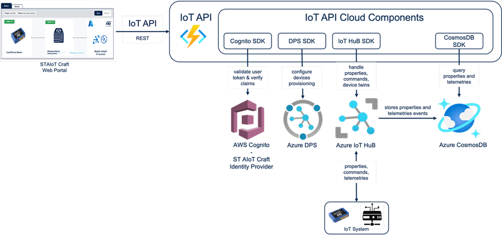

Now that you have an understanding about the entities that the ST AIoT Craft IoT API manages, let’s move to the cloud, where the IoT API and related components are hosted.
The high-level architecture of the IoT API can be summarized by the following diagram:
Figure 2: ST AIoT Craft IoT API ArchitectureFigure 2: ST AIoT Craft IoT API Architecture
As the diagram shows, the API provides a REST interface to the IoT Systems entities, which is consumed by the ST AIoT Craft web portal to provide the IoT functionality. The picture depicts several components, all running in an Azure environment provided by ST to ST AIoT Craft users, except for the AWS Cognito Identity Provider.
The ST AIoT Craft IoT API runs as an Azure function, a serverless compute service that executes code eliminating the need for server management. It automatically scales and charges only for execution time. It leverages three main cloud-native services from Azure: Azure Device Provisioning Service (DPS), Azure IoT Hub, and Azure CosmosDB.
The Azure DPS automates the provisioning and configuration of IoT devices, works with Azure IoT Hub, which in turn provides robust, bidirectional communication between provisioned devices and the cloud. With reference to the previous section, where we depicted the components of an IoT system, telemetries, commands, and properties are routed from devices to the cloud as messages through Azure IoT Hub. The third Azure native component leveraged by the ST AIoT Craft API is Azure CosmosDB, which provides a SQL database to store telemetries and events coming from connected devices: as a new telemetry or event reaches Azure IoT Hub, it gets automatically routed to the Azure CosmosDB service, which then stores the incoming data in the proper table in the database.
The last component of the ST AIoT Craft IoT API is AWS Cognito, which is an AWS native component, that provides a managed service for user authentication and access control. Its main role is to interact with the IoT API to authenticate and authorize the REST calls incoming from the ST AIoT Craft web portal.
This cloud infrastructure is provided by ST to all ST AIoT Craft users. It's possible to experiment with the IoT capabilities of the platform out-of-the-box, without the fuss of setting up the needed components. For advanced use cases, users can also set up their own Azure cloud infrastructure and connect it to ST AIoT Craft leveraging the provided Terraform scripts.

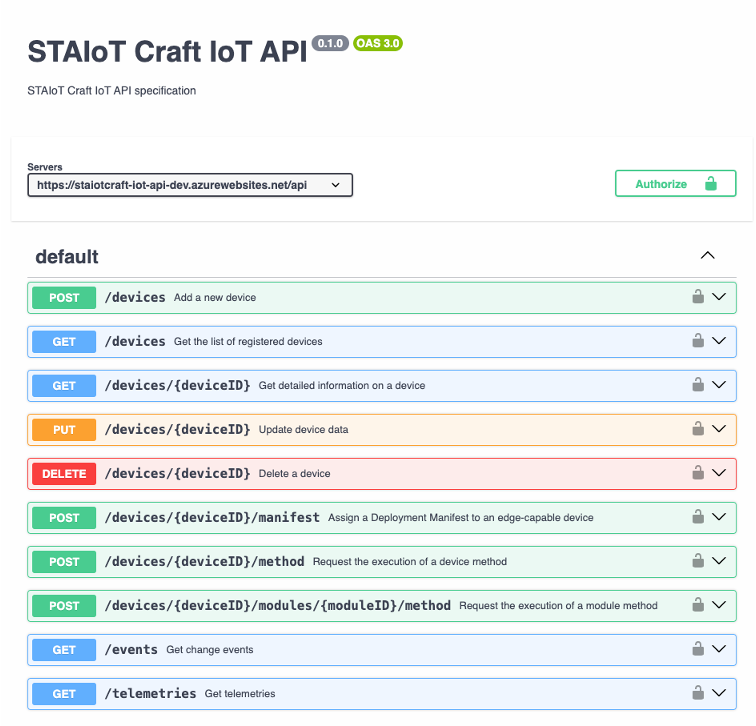

3. ST AIoT Craft IoT API interface
With a clear understanding of IoT system entities and a reference architecture, we can now explore the ST AIoT Craft IoT API interface, summarized with the following picture:
Figure 3: ST AIoT Craft IoT API specificationFigure 3: ST AIoT Craft IoT API specification
