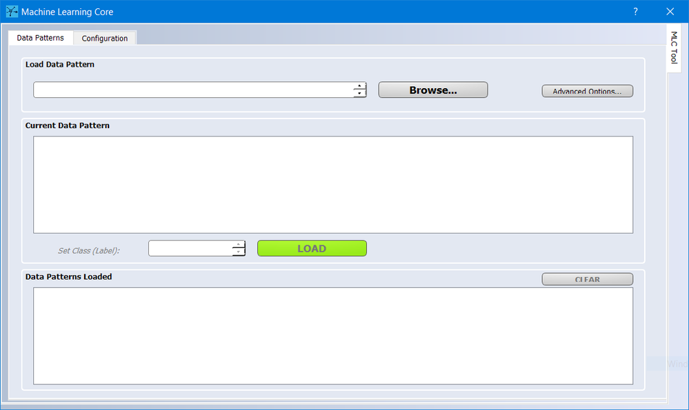

The user has to open Unico-GUI, It is necessary to start it in offline mode by de-selecting the checkbox "Communication with motherboard" on the launch window. Then the user can select ISM330DHCX in the "iNemo Inertial Modules" tab and click "Select Device".
When the Unico-GUI main page is loaded, the user has to click the "MLC" button in the bottom left corner and a new window will pop-up.

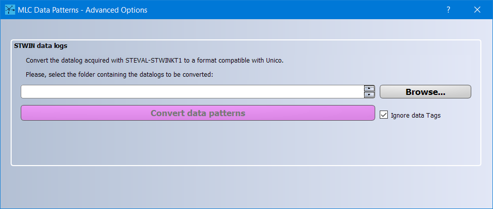

In this window the user can import the data logs, label them and use them as training data for the MLC. Before doing so, it is necessary to convert the log file from STWIN type to Unico-GUI type.
To do so, the user has to click the "Advanced options" button at the top-right corner. A new window will pop-up.
By clicking the "Browse" button the user is prompted to target the root folder of every data log that has been acquired with STWIN (e.g. the folder "Fan_on" which contains all the log files generated by STWIN for that acquisition). Once the conversion is completed, if the operation is completed successfully, a nested folder is generated in the root folder and it will contain a ".txt" file which it is the converted data log for Unico-GUI. The user has to select the option "Ignore Data tags" before starting the conversion.

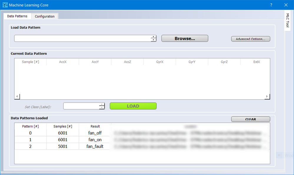

The user is now asked to target those converted data logs and import them in Unico-GUI by assigning a label. A possible assignment for the labels is "Fan_off", "Fan_on" and "Fan_fault".
Once performed this task for all of the 3 logs, the user will see a populated window like the one below and can proceed with the decision tree generation.

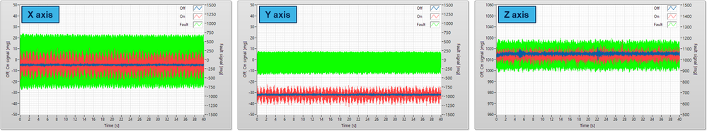

Now the user has to select the feature(s) used by the MLC to discriminate between the different scenarios. In this case, the Peak to Peak of ACC_X (acceleration X axis) is sufficient and should be the only selected feature before continuing with the tutorial. To help the user in this making this decision, it is useful to plot the sensor data in a graphical way with an external software (e.g. Excel, Matlab, LabVIEW, etc...):
It is clear how the peak-to-peak value of the signal changes according to the fan rack mode. In this case, the most relevant axis is the X axis but it may vary (depends from board orientation, fan rack shape, type of failure, double-sided tape used, etc...). For any further info regarding the creation of the decision tree and the choice of features, the user can check DT0139, a design tip document for Decision Tree generation.

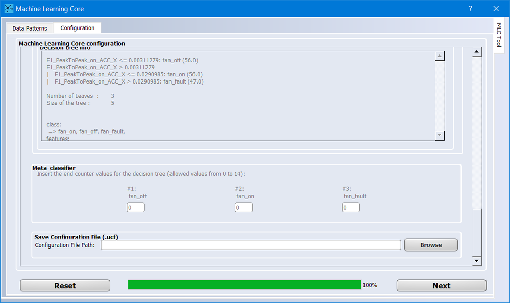

3. Design the Decision Tree Classifier

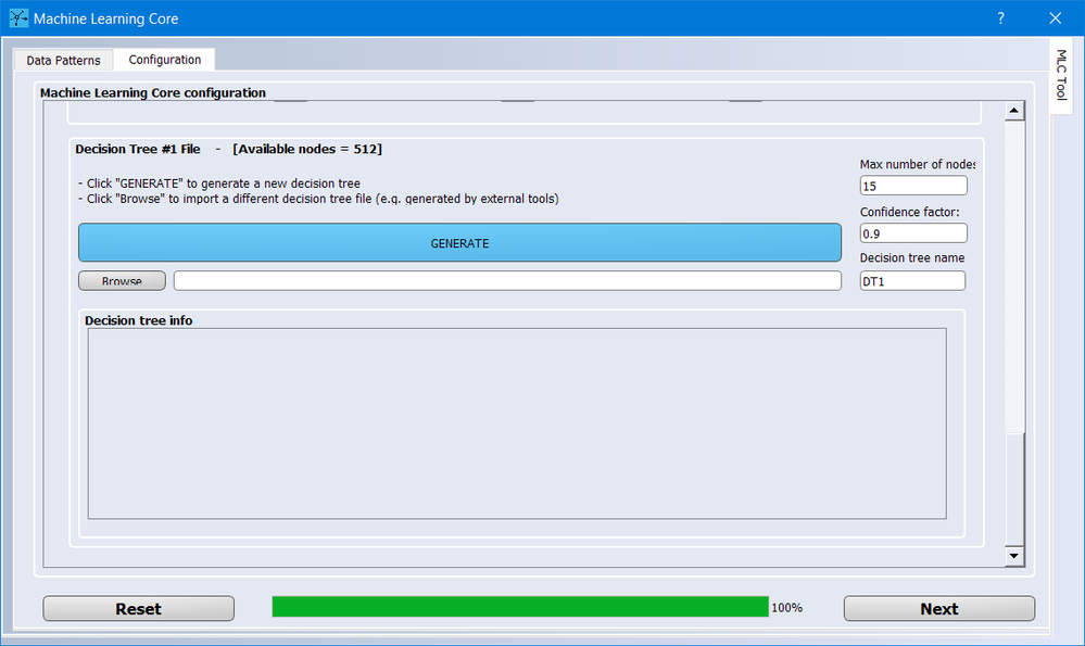

Unico-GUI offers the possibility to design the decision tree using a built-in algorithm without using third-party tools (such as Weka, Python SciKit, Matlab, and RapidMiner) that can also be used as alternative.
The procedure to design the decision tree classifier in Unico-GUI requires two simple steps:
  1. Set the number of nodes and the confidence interval. In this case, 1 node and 0.9 confidence interval are compatible with the application.
  2. Click Generate to create a .txt file that will contain the Decision Tree.

4. Generate the MLC Configuration File
The user can now generate the MLC configuration file for ISM330DHCX by clicking Next after generating the decision tree.
The user will be first prompted to specify the meta-classifier (which is not necessary for the purpose of this tutorial). The meta-classifiers can be left to 0.
Finally, the user will be prompted to select the target UCF file and, by clicking next, it will be automatically generated by Unico-GUI.

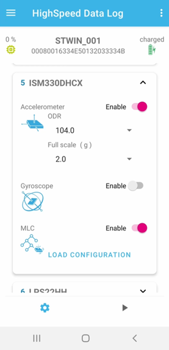

The generated UCF file can now be downloaded in the ISM330DHCX that can be found on top of STWIN,
The user can close Unico-GUI and proceed with the transfer of the UCF file on the smartphone where STBLESensor app is installed. there are many ways to transfer the file (Bluetooth, USB, etc...) . Once the UCF file is saved in the smartphone memory, the user can open the STBLESensor app again and expand the ISM330DHCX settings in the sensor list.
It is possible to see how, by enabling the MLC switch, the "Load Configuration" is enabled, too. The user has to click on it and proceed to select the UCF file previously transferred. It is also necessary to set FS and ODR of the Accelerometer in the same way as we did during the previous acquisition (Full Scale=2g, ODR=104Hz).

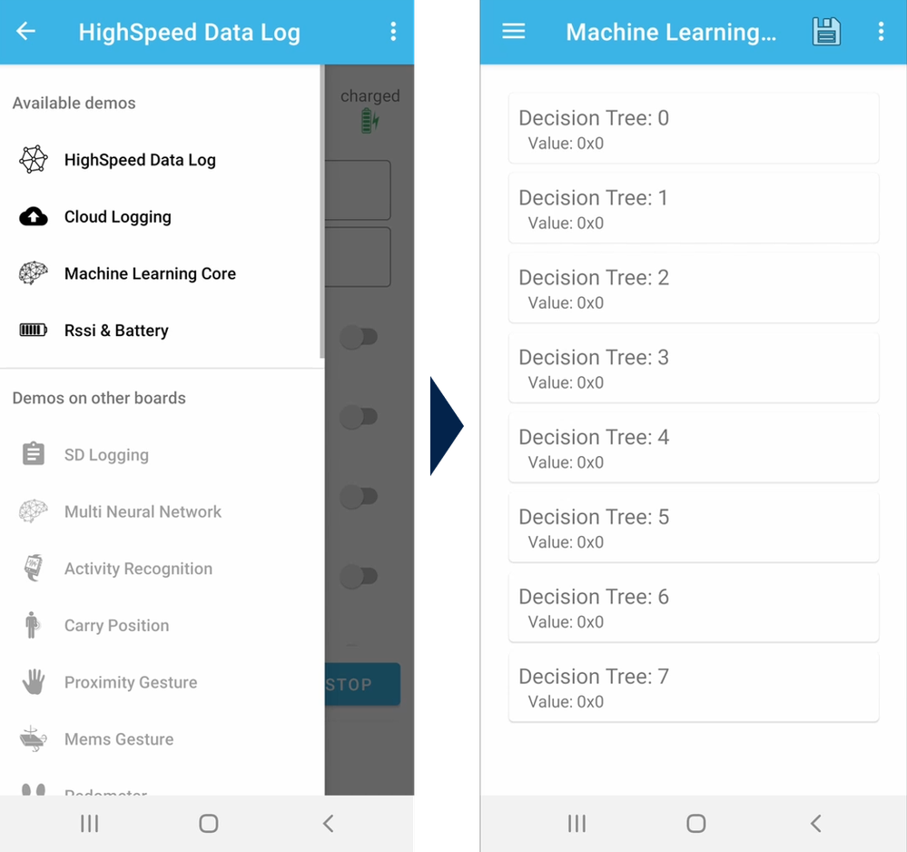

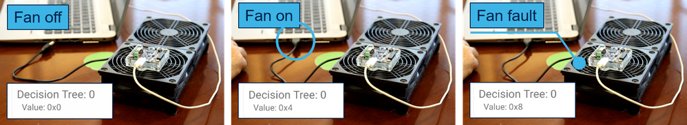

To check the outcome of the MLC in real-time, the user has to start an acquisition. Once the acquisition is started, by clicking the menu button in the top left corner it will find the "Machine Learning Core" menu.
Here, the user will find the real-time outcome of MLC, expressed as a value.
The user can verify that the numeric output of the decision tree corresponds to the working mode of the fan rack.
