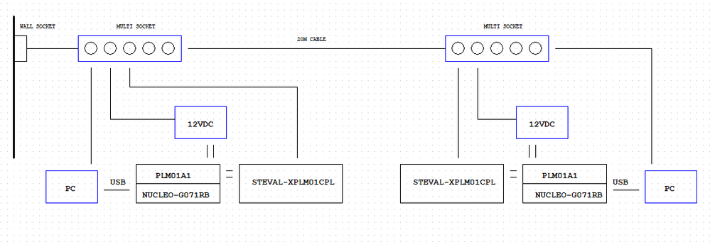

2025-03-19 2:41 AM
HELLO
i have another little update on the problem
the problem seems to appear only if i use an existing power electrical system
if use an external cable (like 20 meters) it works , but if i want to use the existing electrical sistem it not work anymore..
here the setup that is working:
and here the setup NOT working:
i can't understand the difference.. i have tried the not working setup also at home where i'm sure i have only one phase...
any guess?
thank you
2025-03-19 7:41 AM
You are right, the 2 setups should be quite similar.
In the first case, the link is direct and short.
In the second case, you will be more exposed to the noises generated by the other devices connected to the network. Then, the impedance seen by the transmitter could be lower, PLC signal would more attenuated and current required to transmit may be higher.
What is the current capability of your PSU ?
Please probe the 12V to check if it does not collapse during the transmission.
A zoom of the PLC signal at slave side (when the communication fails) may be also interesting.
