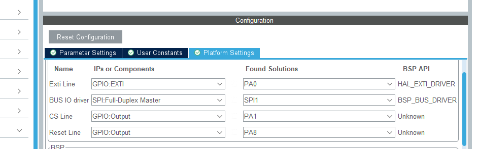

Hi, recently I got a X-NUCLEO-BNRG2A1 and I am trying to use it with NUCLEO-G070RB without success. I have created a project with STM32CubeMx assistance using SampleApp of X-CUBE-BLE2, mapping the pins of the expansion board to my nucleo board as follows:
RST - PA8
SPI_SCK - PA5
SPI_MOSI - PA7
SPI_MISO - PA6
CS - PA1
SPI_EXTI_IRQ - PA0
The project successfully built and uploaded into the MCU, however the application does not do anything it just stuck in the function HCI_TL_SPI_Reset. I have already tried installing the DTM hex file into X-NUCLEO-BNRG2A1, however it does not solve the problem.

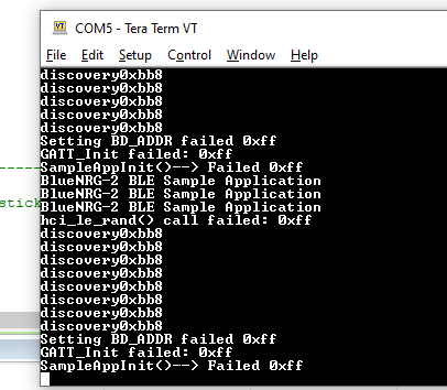

I'm attaching the ss for simpler changes which you said . i just wanted to know regarding hci_tl_lowlevel_isr that it is correct ay to call ?0693W00000WLX1gQAH.png
satyam9896
Associate II

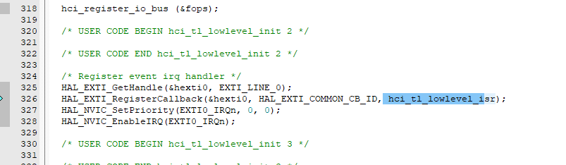

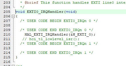

@satyam9896​  Hmm no, remove "hci_tl_lowlevel_isr" from there. When using the HAL it should be done with the function HAL_EXTI_RegisterCallback. You have to only check that you have this in "stm32xxx_it.c":
void EXTI0_IRQHandler(void)
  HAL_EXTI_IRQHandler(&H_EXTI_0);
And that in "hci_tl_interface.c", the function hci_tl_lowlevel_init has attached "hci_tl_lowlevel_isr" into the interrupt:
void hci_tl_lowlevel_init(void)
  tHciIO fops;
  /* Register IO bus services */
  fops.Init    = HCI_TL_SPI_Init;
  fops.DeInit  = HCI_TL_SPI_DeInit;
  fops.Send    = HCI_TL_SPI_Send;
  fops.Receive = HCI_TL_SPI_Receive;
  fops.Reset   = HCI_TL_SPI_Reset;
  fops.GetTick = BSP_GetTick;
  hci_register_io_bus (&fops);
  HAL_EXTI_GetHandle(&hexti0, EXTI_LINE_0);
  HAL_EXTI_RegisterCallback(&hexti0, HAL_EXTI_COMMON_CB_ID, hci_tl_lowlevel_isr); // <--- THIS
  HAL_NVIC_SetPriority(EXTI0_IRQn, 0, 0);
  HAL_NVIC_EnableIRQ(EXTI0_IRQn);

hi, i have done all three changes done but still its showing same errors.0693W00000WLbIHQA1.png0693W00000WLbI7QAL.png
