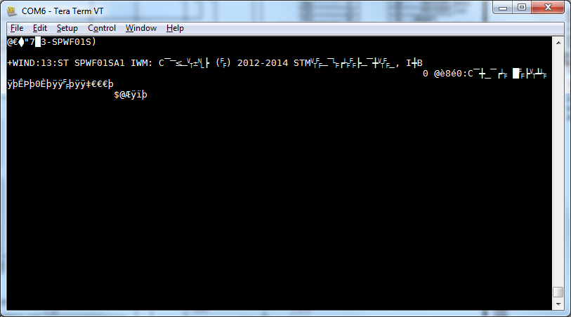

the problem is that my IDW01M1 shild is send a garbage with data and I didnt find:
1. How upgrade firmware
without
nucleo?2. How can I connect a JTAG and use with shild as evaluation board? is there available source code for flashing?
Is there any documention for support this?
Attach terminal screenshot with data from shild on power connection.

2016-12-17 1:40 AM
I'm a little bit confused...
At the beginning problem was Reset Line, then we moved to Discovery board, and at the end problem is garbage on UART.
About the last point, I think Discovery is not properly set. Check clocks (System and Peripheral), and I/O levels (module's high level is 2V5).
About your questions:
