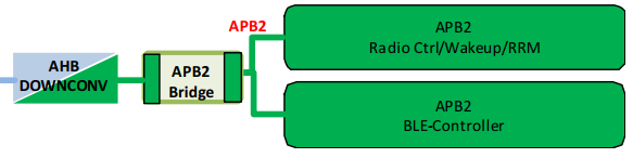

I couldn't find any specific documention but looking in RM0479 and directly in SDK sources here what I understood :
The RRM stands for Radio Ressource Management of the MR_BLE and DTBx is to change the Radio FSM directly through a test bus, if you have a look in function like RADIO_StopTone and RADIO_StartTone, there is byte like 0x39 which should correspond to a FSM state
0693W00000JQBroQAH.pngAndy.
