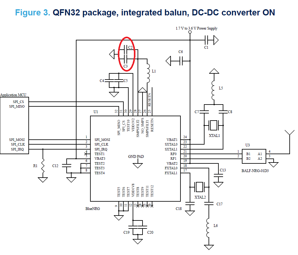

I have also been searching for this information. The datasheet does not have it and I cant find it in any application notes.

Are you designing with BlueNRG? That would be an obsolete product.
Or actually you were asking about one of BlueNRG-MS, BlueNRG-1, BlueNRG-2, BlueNRG-LP?

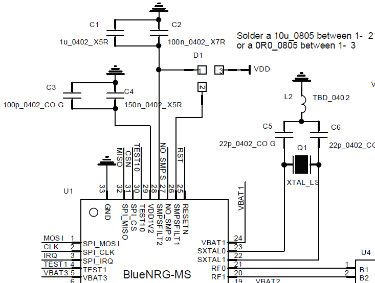

1uF and 100nF for the filtering capacitors.

Thanks, for the quick reply. Where did you find this information? What document?
2021-01-26 6:26 PM
Data brief for STEVAL-IDB005V1 daughterboard.
Link below:
DB2585 Bluetooth low energy board based on the BlueNRG-MS network processor
