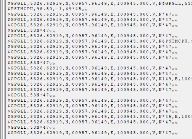

Yes, the device is definitely responsive because it prints my requests and other data as seen in the photos below. Wiring, UART and checksumm are I suppose and CR,LF also present.
Here is the output of my code

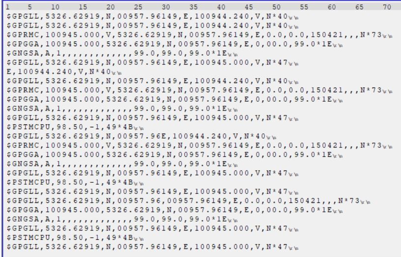

As you can see it is responsive and the GPGLL is printed upon request, but every period it gives a lot of other data like in the next photo.
Is there a way/command to stop any other message except the requested ones ?

2021-04-15 7:25 AM
Your buffering of the USART data appears borked.
Shouldn't be missing characters and lines randomly.
Perhaps implement an IRQ based buffering scheme, rather than polled, and have a deep enough buffer.
Copy the data out of the live buffer (changing under IRQ) if you're storing a line at a time.
2021-04-16 7:51 AM
Thank you for your help,
I adjusted the buffer and the messages are not being Cut randomly.
I solved the issue with the specific messages using the $PSTMCFGMSGL instead of $PSTMNMEAREQUEST.
