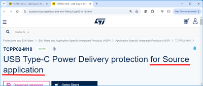

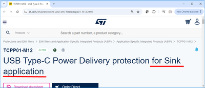

TCPP01-M12 is not reconfigurable and can only be used for sink applications.
For source applications, you must in fact use TCPP02-M18 instead.

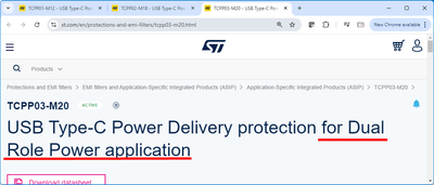

Only TCPP03-M20 can be used as a Dual Role Power Device (DRP) for both.

Indeed - the clues are in the names:

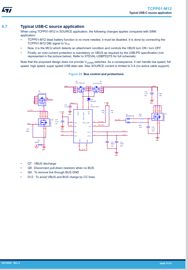

I have old datasheet(DS12900 - Rev 4 - December 2020), in which it was mentioned that tcpp01 can be used in ucpd source mode as well as sink mode. I am attaching the screenshot . Kindly verify

Well, in principle you can actually use TCPP01-M12 as source, but the restrictions are also mentioned in section 6.7. So TCPP02-M18 is necessary for full source functionality:
Note that the proposed design does not provide VCONN switches. As a consequence, it can handle low speed, full speed, high speed, super speed USB data rate. Also SOURCE current is limited to 3 A (no active cable support).

I warmly recommend following this recommendation : TCPP02-M18 for SOURCE.
