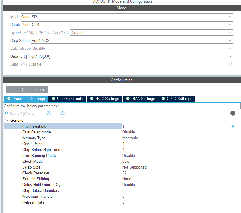

Hi, I am Driving an AMOLED display (GRAM) with QSPI.
In blocking mode everythings works fine, but now I trying to "update" it using GPDMA, nothing works. Any advices ?

Now in the DMA, i replaced the HAL_OSPI_TRANSMIT with :
HAL_OSPI_Transmit_DMA(&hospi1, param);I also updated the CubeMX configuration :

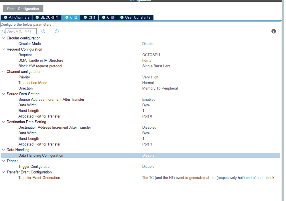

and for GPDMA:
To be honnest at a certain point I tried all the possibilities with GPDMA port - direction - and so on with no success, so I kept what made more sens to me.
Can someone point me out my mistakes or a way to dig into ?

Ok, I dig more into it, I figured out that if datasent count is lower that 0xFFFF then HAL_OSPI_Transmit_DMA works as expected. But in the case of sending more data it "breaks".
I made a bug report and waiting ST response on that, here with minimal code to reproduce:
