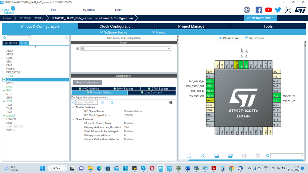

ANy configuration needs to be done using STM cube Mx which is missing kinfly

we would like to confirm whether we have missed anything on the I2C configuration on STMcubeMx ..
Any IDE issue seen here...let us know...thanks
