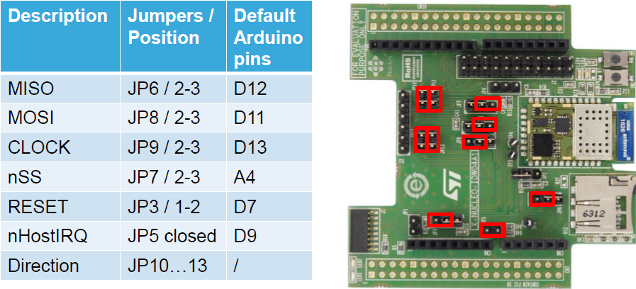

Please be sure to have set jumpers on X-NUCLEO-IDW04A1 in the right position
