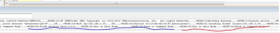

The problem is not an issue with the ST Middleware as it is slow switching times in the SPWF module between data and command mode in SOCKD mode. This picture shows in blue a TCP message receive and red a message send. The switch time total is 88mS for a 20 byte message.
