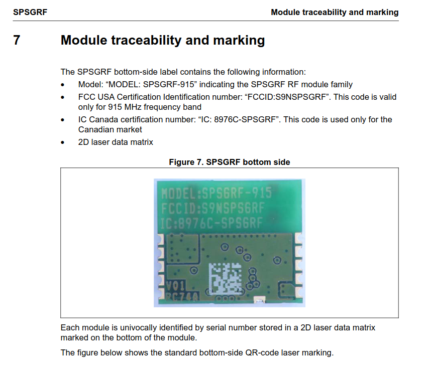

2023-08-20 11:56 PM
Apparently the "-915" characters were made with a CNC drill. Perhaps both are clones. The datasheet shows the complete code made directly on the board layout:

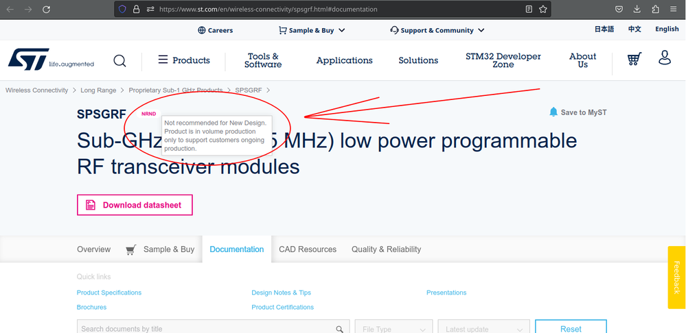

2023-08-21 12:17 AM
I found the status of Obsolete, maybe that's why some manufacturer could be reproducing it:

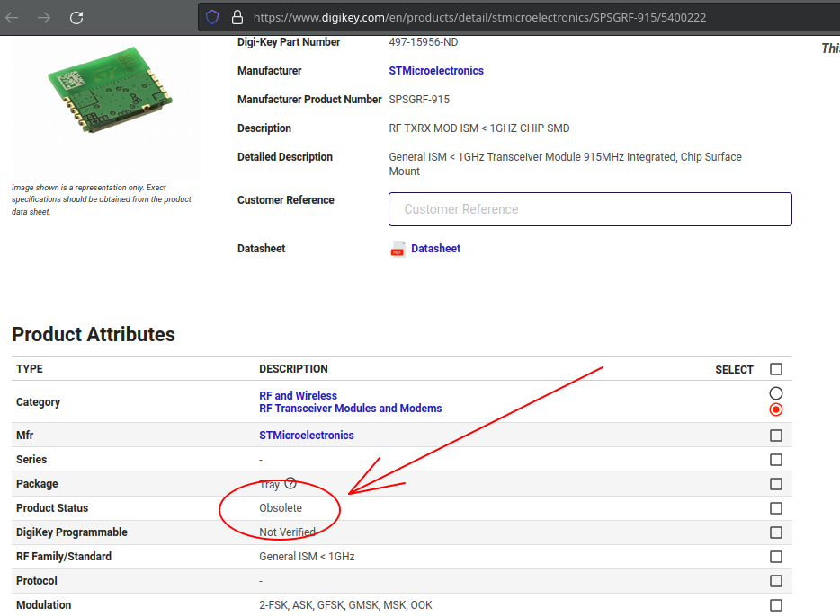

2023-08-21 12:18 AM
2023-08-21 12:46 AM
Thanks for sharing this information. Yes, we know it's OBS part.
