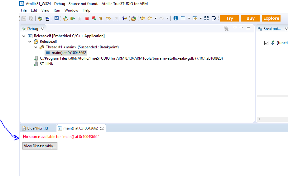

Posted on May 21, 2018 at 13:42
Thanks Jerry, I really do appreciate your replay.
I have added that line to the linker file 'BlueNRG1.ld', now Atollic 8.1 is able to program SPBTLE-1S,
But unfortunately it does not find 'main()' source, as can be seen in the attached imaged (blue arrow).
Can you please assist?
Posted on May 23, 2018 at 11:51
Seems you are trying to debug without having debug symbols included, or code is optimized (e.g.: release mode). Check CFLAGS

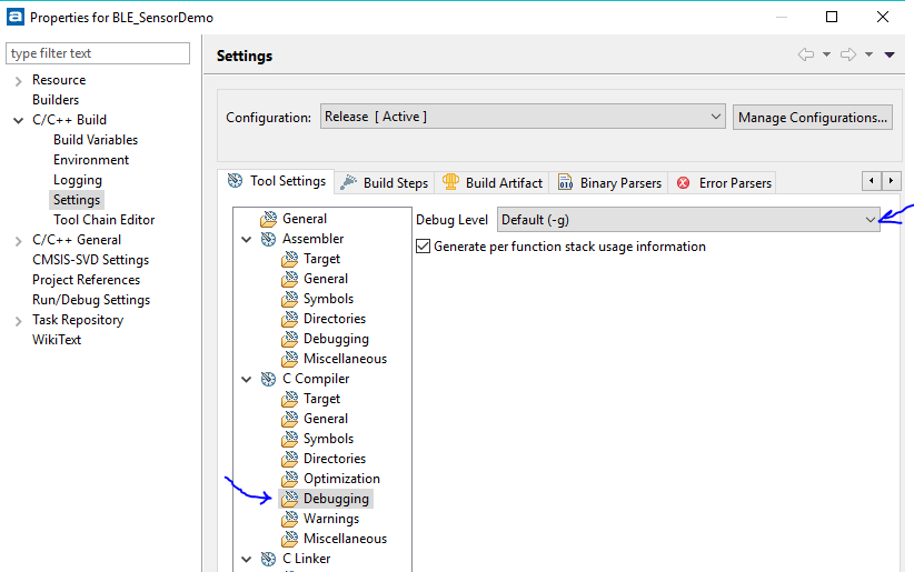

Posted on May 23, 2018 at 13:44
Well, I am using official ST example project - 'BLE_Sensor Demo', shouldn't it work out of the box?
Anyhow, I have found that debug level was originally set to none, I have changed it to default.
In order to assist other users, I have attached screen shoot.
