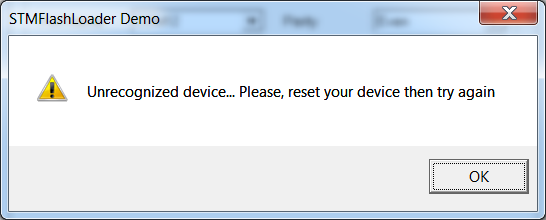

* Open software ''Demonstrator GUI'' for loading flash files. configure the UART for Parity = Even, Stops Bits 1, COMport: COM12:
* Clicked on Next. Failure Message is displayed as ''Unrecognized device. Please reset your device and try again.
* Tried Resetting the device and repeated the above steps but result was same as mentioned in above step unrecognized device.

The problem could be that you are pressing the Reset button, right after you power up the board with the BOOT0 signal connected to 1.8V.
Try the procedure, but do not press the Reset button, and see if it works now.
2018-03-27 2:20 AM
Hi Lokesh,
did you succeed?
In case, at which voltage you are supplying the module? Note that you have to set the Boot pin to the same voltage level of the Vin pin. So, if you are supplying at 3.3V, it is not correct to set the boot pin to 1.8V.
Also try to lower the UART baudrate in case it is matter of signal quality in your setup,
