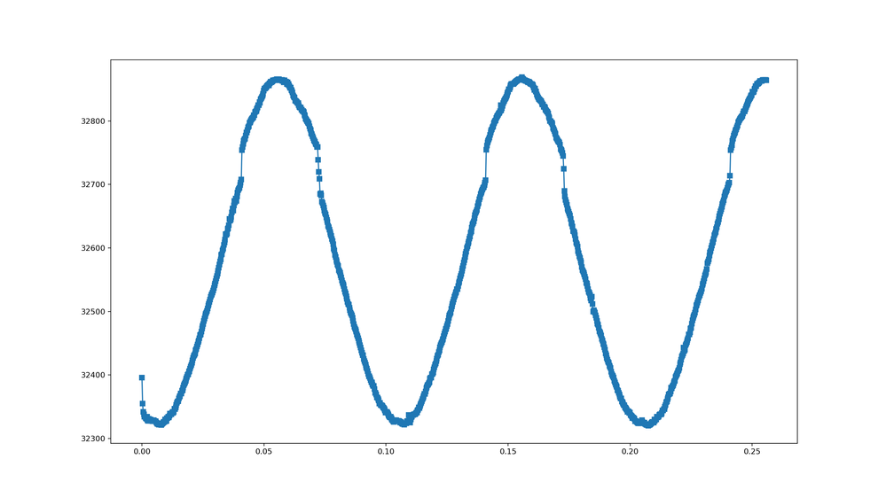

What I'm seeing is that the ADC skips over a range close to, but not exactly at, the midpoint of the sample range. In 16 bit mode the range is approx 32700-32750 (with 32768 being the midpoint). See attached images (X axis is seconds, Y axis ADC code).
This is with the downsampler active.

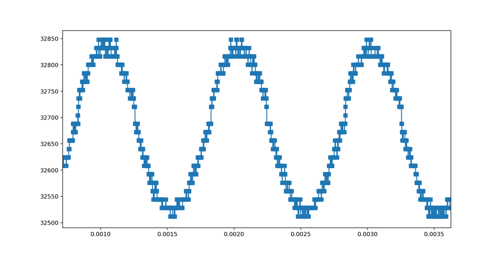

And this is sampling at full 1MSPS, no downsampling. Data is left shifted but you can clearly see that 1 or 2 codes are being skipped. This is a 1kHz sine wave input.
