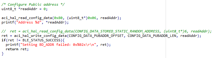

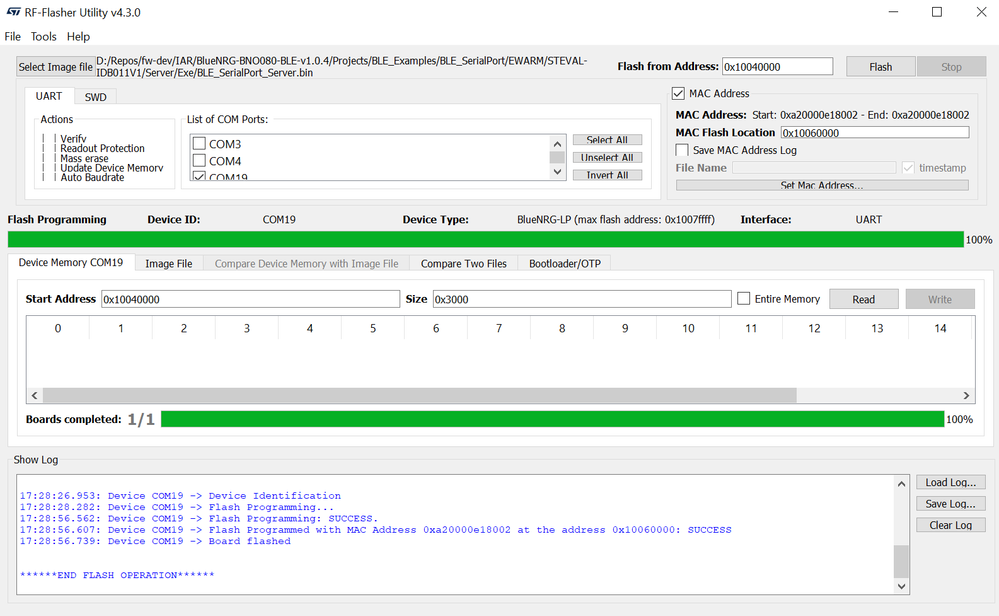

Please find the below images for setup. I am setting the public address.
The below is how I am setting it using RF Flasher Utility.
So I first read the address stored in the NVM, and then I write it using the aci_hal_write_config API call.
Thanks!

Hi @amankumbhani ,
Ok : Let me also point this document : UM2406 : UserManual of the RF_Flasher section 6.
This tool is used to flash MAC address at a specific flash address as you did.
Anyway, in your application code, you must program it:
1- Read MAC adress at the flash address you flashed it.
2- Set this MAC adress using aci_hal_write_config_data(...)
Then a third step, of course you can perform a aci_hal_read_config_data() to confirm is has been well programmed.
Regards,
Sebastien.
