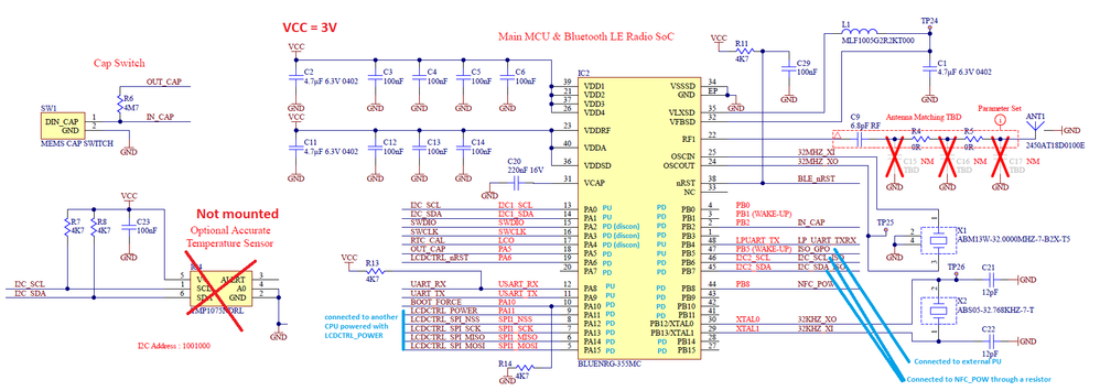

Part of the schematic that I can share:
IO init:

Laurent LOUAZON
Two things here in my mind
  • Leakage problem could be related to PA7 / PB0 / PB1 / PB3 / PB9 / PB10 / PB11 / PB14 / PB15 that are configured as analog No pull while they are not used. If IOs are not used, you should not initialized them so that the pull used will be the one defined with LL_PWR_Enable. Please try not to initialize those IOs as analog if not used.
Again the problem you faced is typical of an IO set as input and no pull is present.
  • I am not sure to get why you are initiliazing IOs used as UART,SP�?, I2C etc as GPIO input with pull up/down. I guess they are programmed in other place with proper alternate function.

jbie
Associate II
It's working with the first remark, thank you ! I does not know that "normal state" init override "sleep state" init.
